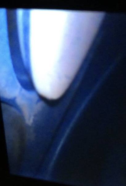

With my old cam there was a mile of room, but when swapping to a cam with more duration my brother put his borescope to use. I was going to advance the cam to buy up some clearance but after seeing the room I still had I just lined it up dot to dot. This is using a 1.74 valve with a 234 @ .050 duration.
This is just as the exhaust valve is about to close completely and the piston is getting right to the top. I can get you the video if it would help you. We didn’t pull the heads to do the cam swap so as far as measurements... this will have to do however this is AS close as the valve ever gets to the piston.

Actually it looks ok.. Me being me, I would probably still measure it but you have more room than I expected...

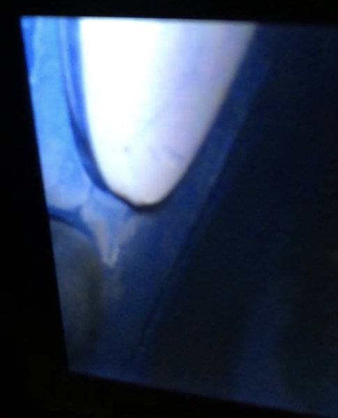

I was damn near losing sleep over this issue, because the cam was being changed from 208 to 234 and I had to have the car race ready in very little time. Once we actually put it to the test I felt silly for even worrying about it. It runs great, super strong, and isn’t even close. I’ll get a good measurement when I put my 1.81 valve heads on it. (This photo is a couple frames later Piston not all they way up, but close)

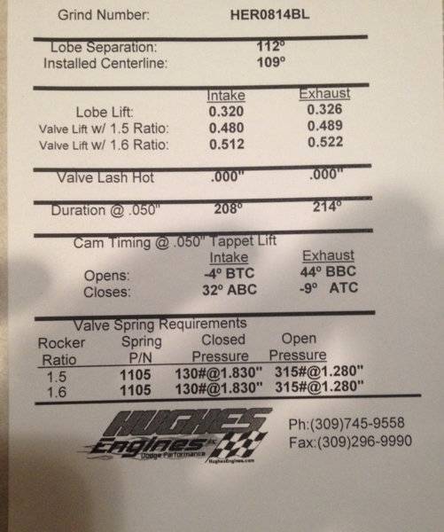

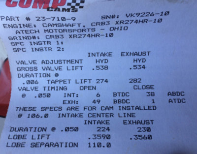

I got my numbers wrong off memory... it’s 230 not 234... the lift is .534 so it screwed with my memory... haha but here are the cam cards Comp is the new one, Hughes is the old one.
CC0AF9ED-2AF2-4098-B90F-CBF39454DF07.jpeg 8209040A-5C58-4934-9946-31E8321B7E08.jpeg

The intake is 224@.050. I'd worry more about head flow and combustion chamber shape than compression and quench at this stage. A good pair of used aluminum eddys is probably close to the cost of fixing up old stuff. Not worth it to swap pistons either. Advance the cam another 2-4 degrees and let it rip.
