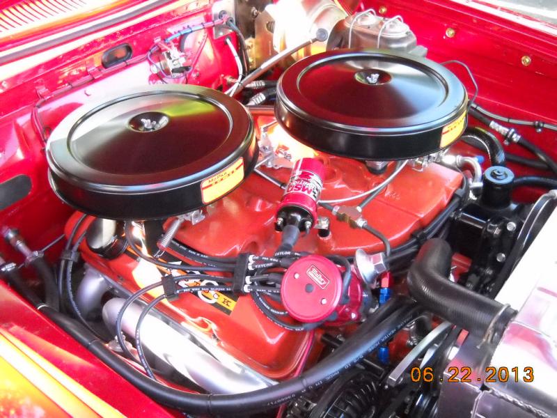

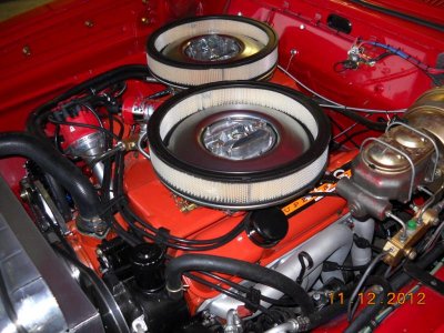

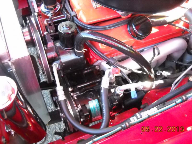

1.Set-up #1 puts the compressor "up" on the top over the power-steering pump" See my pics.
2. Set-up #2 puts the compressor low right side down by the fuel-pump. (would not work for me on the Hemi)
So, I know mine is a Hemi but if it is available for the Hemi, it should be available for the 6-pak.
A GOOD and positive thing is: the 6-pak coil mounts on the manifold on the right side. This would give you clearence for your compressor up-front.
I had to relocate my coil to the rt side fender-wall.
Let us know what you do....

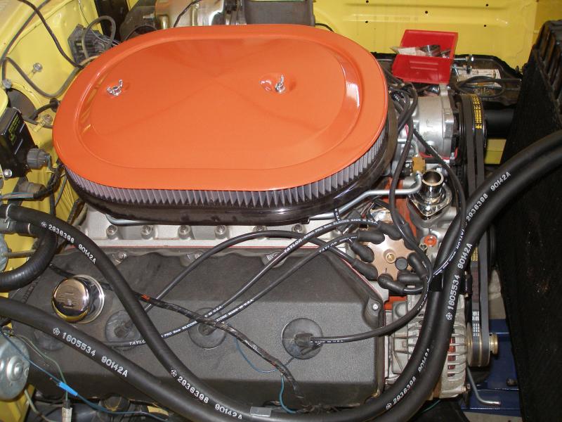

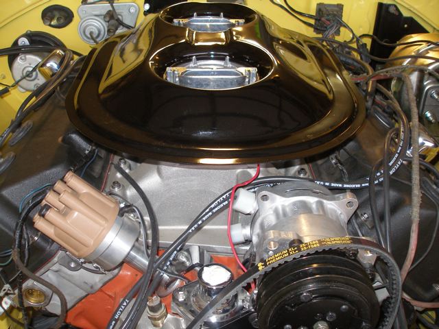

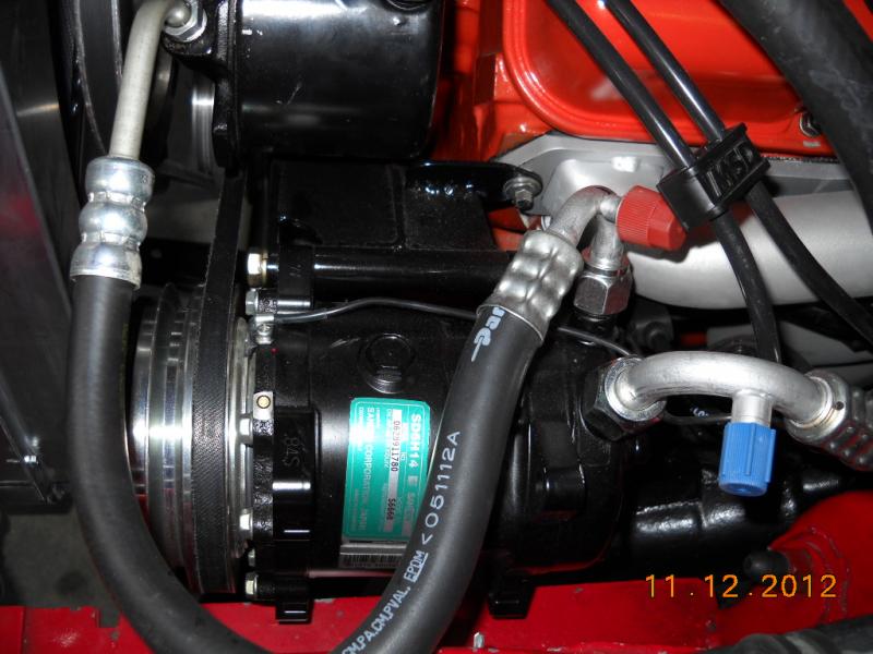

Here's a max wedge motor with Vintage Air, P/S and P/B. I'm old too...lol
