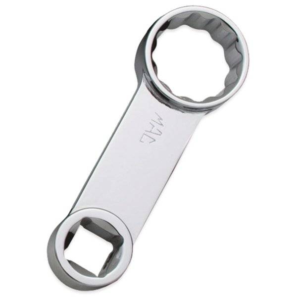

They are called "Box end torque adapters" MAC Tools sells them
Make your own with a wrench
take center to center length plus 12 and divide into torque spec x 12
you said 35lb so 12+2in = 14 35 divided by 14 x 12 = 30lb
