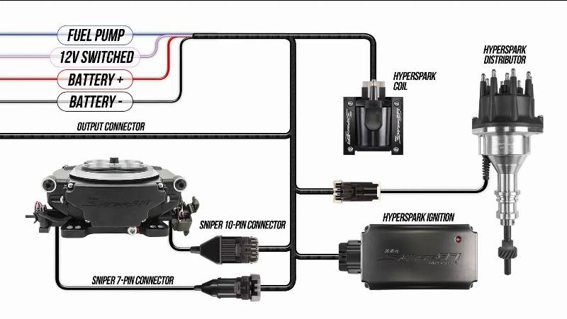

If you have a factory tach you will more than likely need to use an MSD Tach adapter to get it to work properly. The Hyper Spark Coil and Distributor hook up to the Hyper Spark Box independent of the original wiring. See the image below. You need 4 wires to hook up the entire system. Fuel pump wire to new Fuel pump. 12v switched, battery pos and battery neg. Everything else just plugs in. You can tape off your original coil wires they are not needed for the Hyper Spark to work. Keep them functional and throw your old distributor in the trunk as a back up plan..... Ya know just in case.
