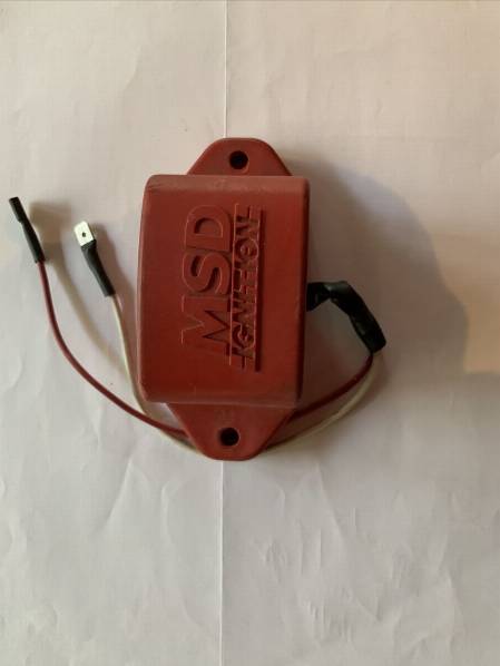

I have had the car running off the EFI system before and yes I know Todds Restoration He has done work for me beforeLike I said get the car up and running without the factory tachometer. Then figure out what the tach needs. It will be drien off the efi module. You will most likely need a driver/tach adapter for it to work. There is a guy here that works on these dashes and he might be able to tell you if the tach will work or not and if not what you might be able to do to make it work. Big thing is do not add anything into the efi system as it can bugger things up. You want it up and running on the new ignition/efi system first.
