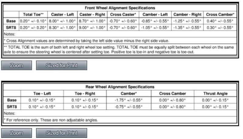

Negative camber helps with handling and roadholding capability. Look at the specs of a late model Challenger:
Right side is well over a full degree yet these cars don't chew up the tires.
