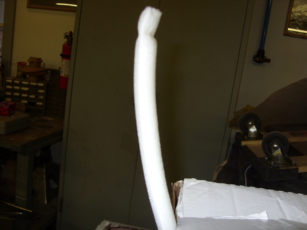

Double sided foam tape? Could you 'splain how you're using that?
Here is what I use when I tape off the jambs.
cranky, that 3m foam tape is great like xman and dvw say, we use it at our shop most times on late model deer hits ect, the hood to fender gap , door to rocker/sill ect that foam does not leave a ridge line with the clear coat like tape will,
once done and unmasked you can take a piece of 1,500 wet and just scrub the meeting point of the old and new clear, follow with a little 3000 compound on a shop rag and wala.
