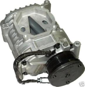

A magnetic clutch on a roots type blower most certainly WILL work Mercedes Benz has already done it.

What can i say, where there's a will, there's a way. I think toyota used those smaller eaton supercharges like the benz used too. Its easier to see how it would work on a fuel injected motor as the computer can adjust fuel trim. Thinking in terms of a carb set up i just didnt see how having 2 carbs set up for a blower would work once the blower turned off.

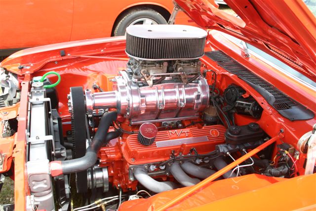

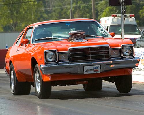

I've had a blown street car since 1985. It's no world beater but a quick street ride. This is what I've learned. Stock Carter Comp 750 AFB jetting is dead on. You don't need a lot of timing (30 total), or you'll need a lot of pistons. 8-1 at 12 PSI lives on pump gas, I do use race gas at the track. A iron headed 340 with a 240@.050' cam will run 11.0 in a 3875 lb car with mufflers. This is with a 6V-71 blower mounted on a single 4 barrel intake. A clutch on the drive will only work if the air by passes the rotors. I've driven mine W/O the belt. The rotors will spin, but what a dog.
Doug
