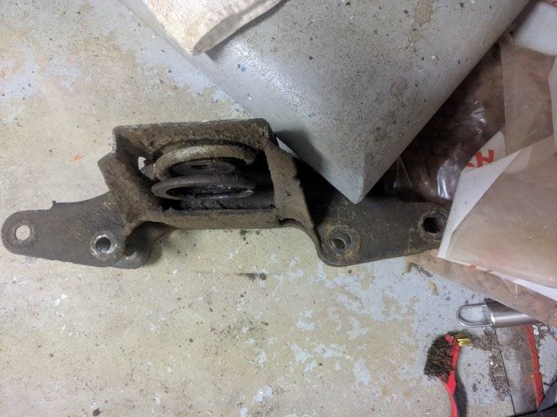

P.S. the transmount on this thing is a trip.. didn't expect a giant spring

Here ya go.. i think my car might be a early build or something.. everytime i looked up 62 mounts i saw more normal ones, this one has a square rubber biscuit that is mounted to the trans then sits on that spring and a bolt with a long shoulder holds it together, i couldn't find a mount, looked up 1961 mounts and found one right away.. i also have floating power motor mounts...
It's upside down in the pic...
And i ca't wait to have this **** all clean, everytime i touch this car i end up looking like a grease monster

I have a similar "spring thing" trans mount on my 1962 - 300. Kinda looks like the trans would walk all over the place under load.
I assume yours did not have that feature?? Ive never seen one like it.

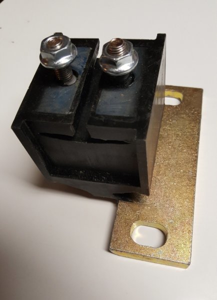

You're correct. And the rubber one that's on my '62 Dodge is a little different than the later years also. It's a little hard to find the exact one. They look similar to the later ones but won't work. The later ones have the metal bracket centered under the rubber block. This is the one I have.
my 62 wagon is like this... looks strange to me too. can't remember seeing a set up like this on any of my 62's before. but i will have to go to the later mount since im putting the 833 in it. Has the square engine mounts that go on the flat spot on the frame for the mounts. my 62 crew cab is way differnt.

The Trans mount... $22 new... my early mounts were starting to split, i drilled a hole through the drivers and ran a bolt through.. solved :)
