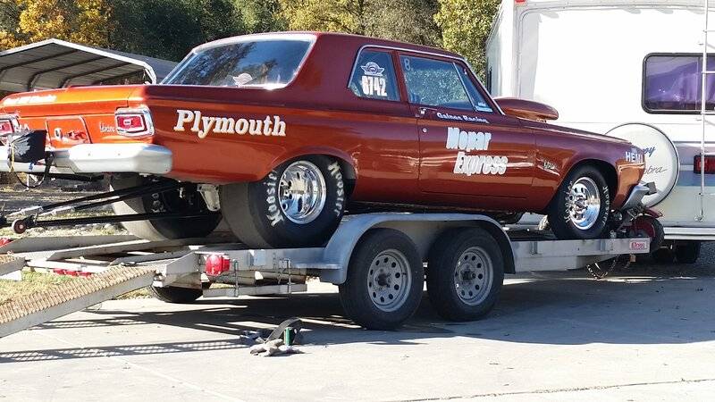

Got the chassis all setup now to use my trans brake for launching the car.
The chassis setup should now be able to handle a 5000rpm chip in the trans brake circuit.
I was only able to use the foot brake on my only outing on the car at the NHRA March Meet.
I had to footbrake it at about 2000rpm because the chassis wasn't setup right to use the transbrake (or the footbrake at anything over 2000rpm). When I tried to use the transbrake (with several different shock settings) the car did everything but leave smoothly...it bounced, it porpoised, it spun, it did everthing but HOOK. Now I have done Major changes to the chassis, ladder bar setup, wheelie bar setup, spring rates and shock settings.
The best 60' time I had was only a 1.334 when the car went 9.26.
Looking for something in the 1.25 to 1.28 with the transbrake at 5000rpm launch.
If it hooks and I can get the 60' into the 1.20's then I hopefully will have my first 8 second time slip.
I told a buddy of mine if I get a solid 8 second time slip I might just park it and oodle over that time slip for the weekend .... lol. Wish me luck.
