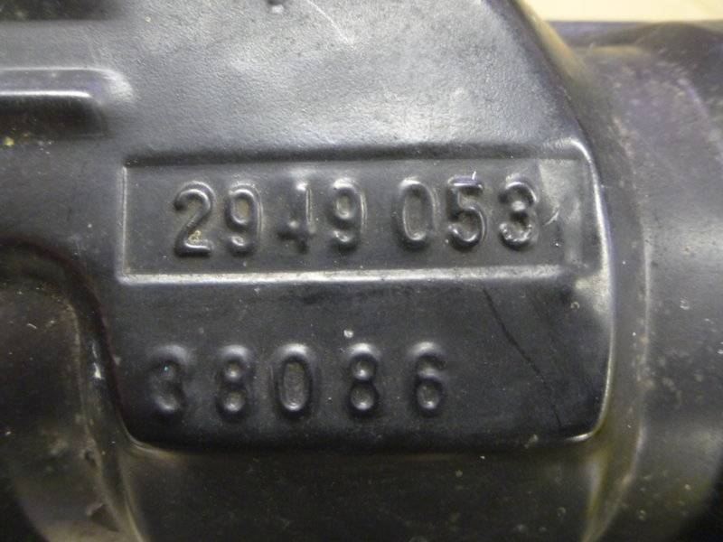

Hey.
I have a roadrunner -69.
On the broadcast sheet it says:
Rad 53.
Can anyone tell me what that means?
Is it a 22” radiator? Or is it a 26”?

Thank you both for answering.
Do you or anybody else know where a can buy a radiator like that one.
I want the car to be as original as possible.

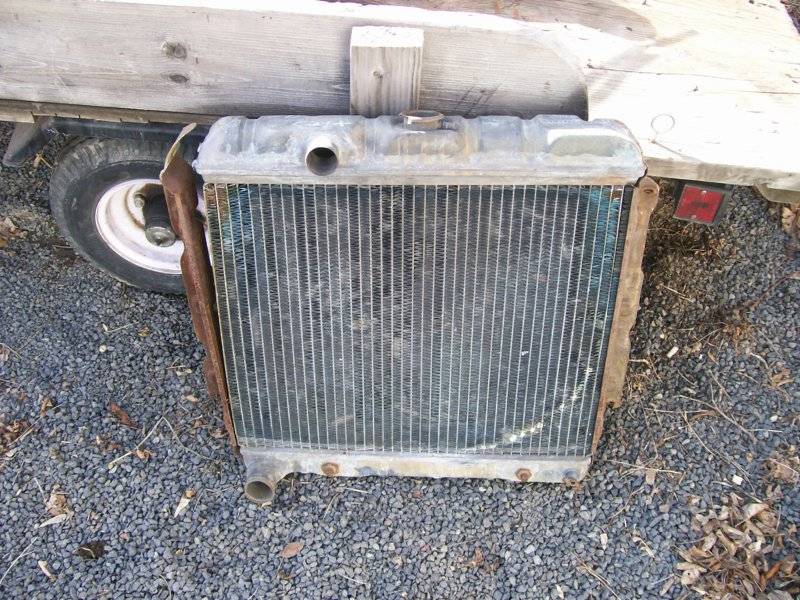

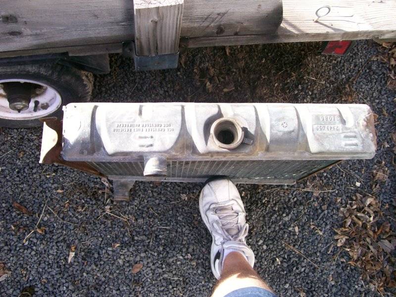

Oh I agree with you, where else you going to go to get some quality mopar work. I will hire him again if/when I need another radiator. Just a bit pricey and was trying to convey that to the OP so he would be prepared. Mine also runs very cool like yours, on a 499 CID stroker no less. IIRC, I had Bob put in a 3 row HD core when he rebuilt it, I think the OEM was just a 2 row? I just didn't have the original anymore and the only core we could find at the time was $200 or $250 IIRC. Also had to ship it from Oregon to Wisconsin to Indiana, so that adds some too. Plus the new shroud. It all added up to $1180 in 2008 dollars. Here's what the core looked like before Bob worked his magic on it.
PS. Not my foot! :xscuseless:
Yep, 2 row is stock OE and 3 row would be HD. I couldn't find a 3 row core when I had my 053 redone for my Bee and had to go 2 row. Works just fine with my stock 383 Magnum and runs right on the stat. My spare 053 that I picked up is a 3 row recore, that was recently done. Just found out that the '69 RR Vert I was working on was sold out from under me yesterday so if Stefan @Stefan wants to work on a deal.. send me a PM ..

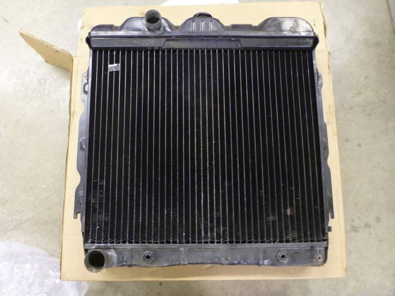

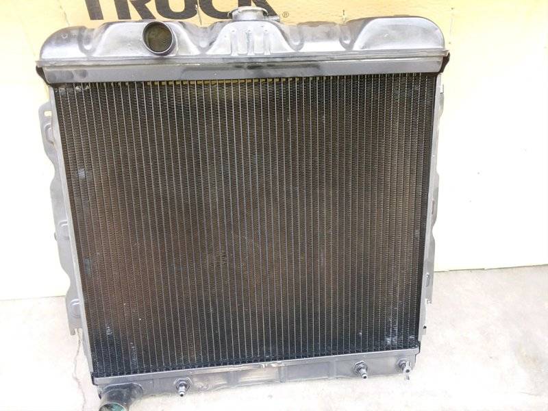

Stephan, Here is a nice never used recore I have.
$800 plus shipping.

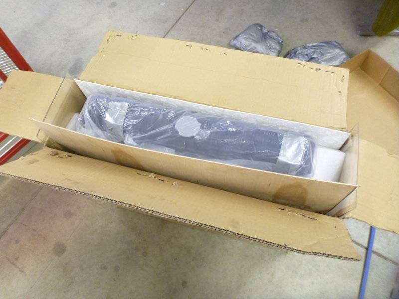

On it's way Stefan ! I probably should have kept it as my spare, but better that you put it to good use! My wife agrees.. LOL
