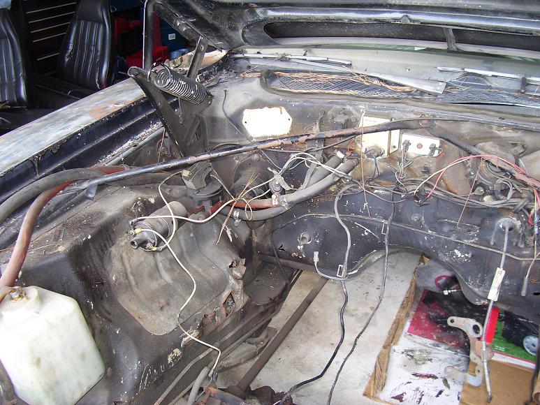

Not sure if this helps, but here is a 73 original SB car and I am sure that bottle is factory. Can't see it all, but you get the point.

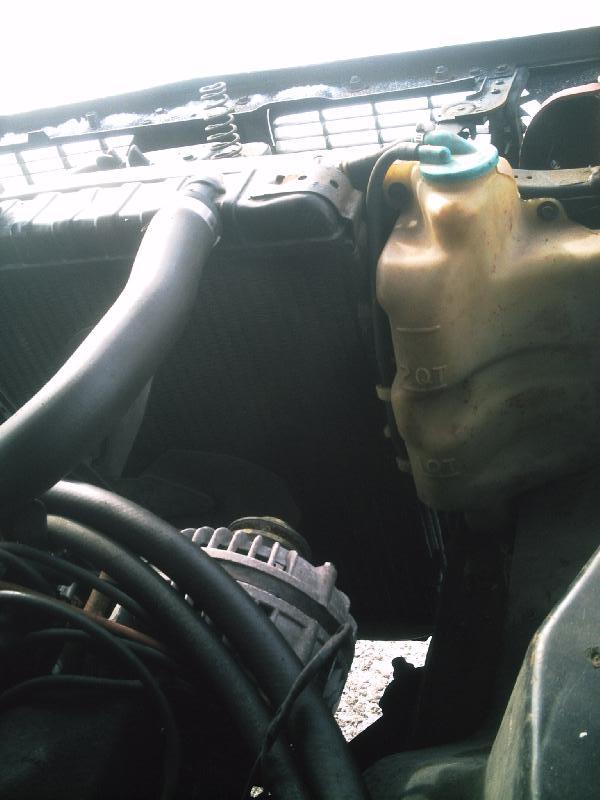

I'll get a better pic later today, but this is the bottle in my '74 big block. You can have the one I pulled from the '73 Satellite. It's not pretty, but it's cleaned out and not cracked. Also, there is no bracket on the bottle, but there is a circular bracket on the charcoal cannister that has a flange that attaches to the overflow bottle.
