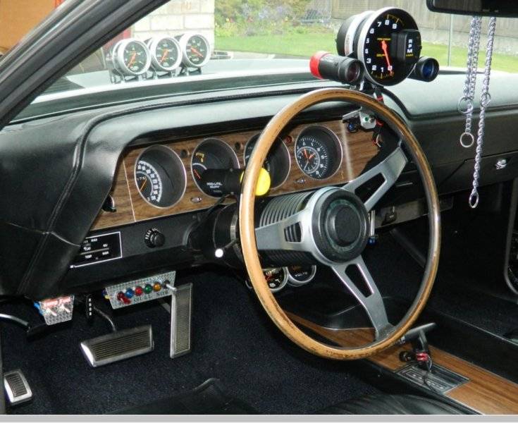

Nice restore on that dash. :thumbsup:
Now please remove the big stupid tachometer. lol
I know, right? It is very handy to know what the RPMs are but that thing looks tacky. I may buy a small one and place it under the dash somewhere.

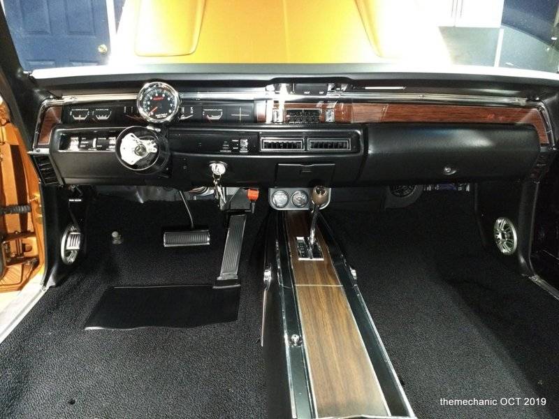

Looks nice, but, $275 for the tach and remove the switch panel (which will ruin my dash pad) to install it. I don't think so.
You can install one of those tachs without removing the switch panel. Take out the radio and it is a piece of cake.
Taking out the radio is no small feat with aftermarket A/C and gauges under dash.
I'll stick with the big ugly tach for now. Maybe downsize later.
