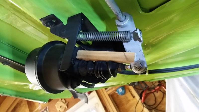

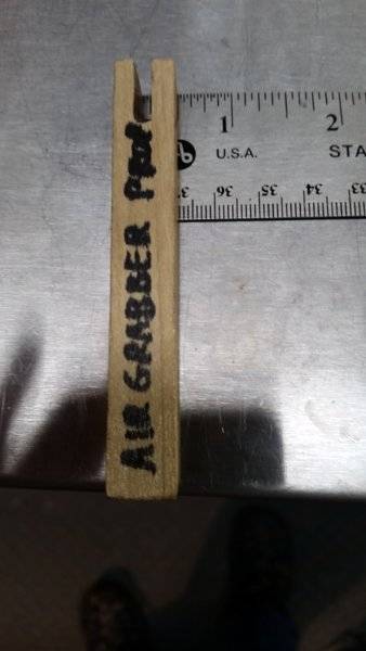

I use a HIGHLY TECHNICAL method to keep it open at shows: :rolleyes:
Yes, it is a piece of WOOD with a slot cut into it! I can open the scoop by hand, slip the wood piece on, and away I go. It takes second to put it on and take it off, and it does not disturb the proper function of the air grabber.
Hope this helps,
Hawk

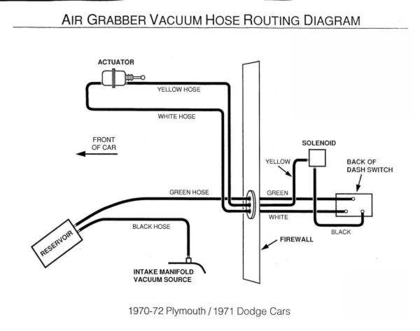

Take the yellow hose off the solenoid and put it on back of switch where the short jumped hose is and that will eliminate the solenoid.
