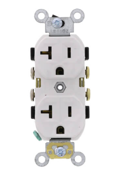

12/2 wire is used for a 20 amp breaker. If you have 20 Amp wire, you should have 20 amp receptacles. They look like this:
View attachment 1585368.

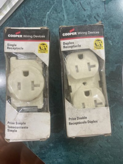

I have some 20 amp receptacles that I was going to use on the battery charger plug and a mini fridge. That’s the heaviest things I have in this shop. 42C77FCA-B574-4D21-8D9B-BF33807FDDDE.jpeg
