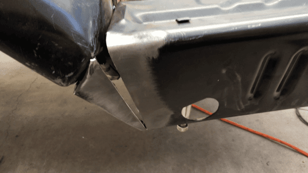

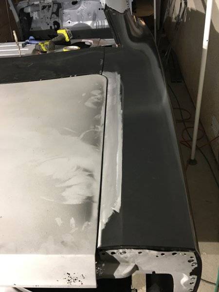

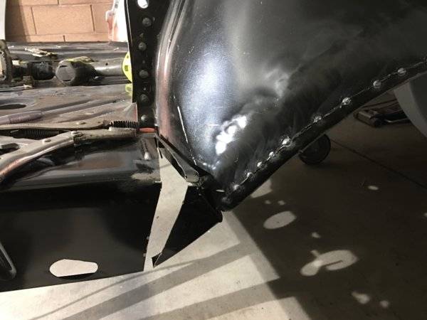

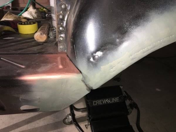

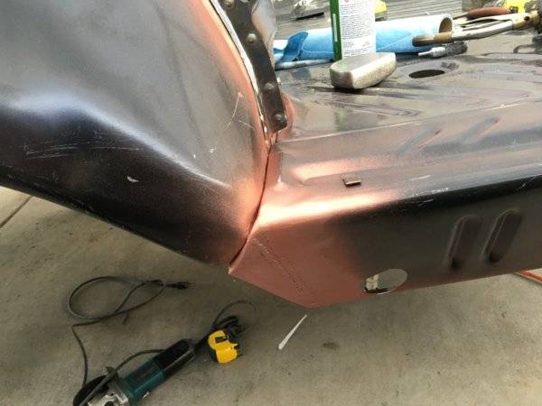

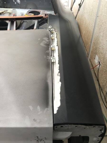

AMD has a new supplier and their fitment is crap, tried to install wheel houses from the new supplier and not even fuckin close!!! I had one of their old wheel houses still and it fit great. Had to slice and dice the outer wheel house and then had to extend the trunk extensions. Plus none of it has the sharp edges the factory metal has. Prices go up and quality went down
that is the part that has been retooled 4 times
so there are at least 4 different versions out in the market that i know of (maybe even more versions by now this was a few years ago!)
i had 3 of the versions at one time
all are JUNK
the problem with them is when they first made them
the original sample was from a 4 door car
and they were too stupid to know that 2 door and 4 door outer wheelhouses are different.
so they have been retooling a 4 door version to a 2 door version which has been a total cluster ****.
they should of scrapped the whole damn thing
and started over with the correct 2 door sample
my info comes straight from the horses mouth (AMD honcho)
but i had to beat the living **** out of him to get that information.
I bought full rear 1/4s, trunk floor, extensions, both inner & outer wheel houses, and Dutchman panel. I didn't have a single piece that just dropped in and fit. The wheel houses & Dutchman panel were the worst. I have tool and die experience and it was easy to see it's just poor workmanship on their part. Pieces that should have been mirror imaged weren't even close. Ya just gotta make it work, within reason.

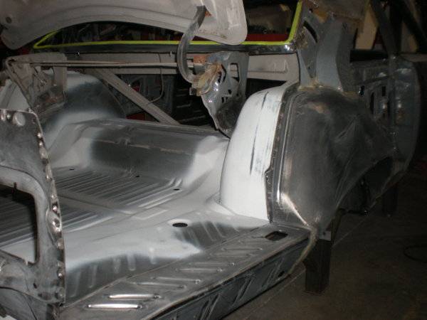

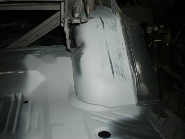

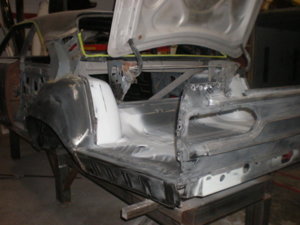

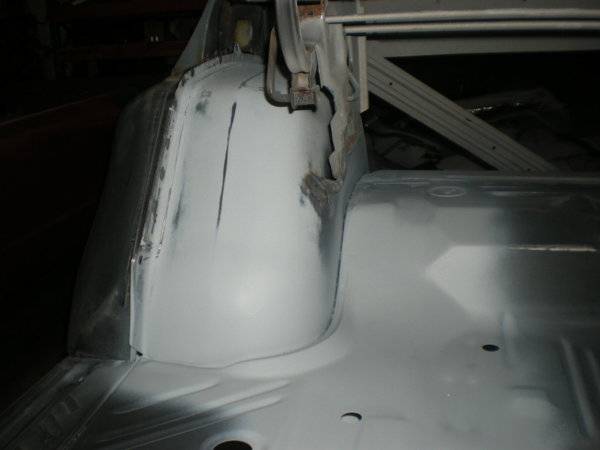

Wow sorry to hear - It just sucks... I was Lucky i guess wheel houses and Quarters went really good even as we widened up a bit..
