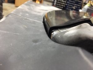

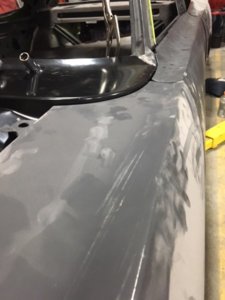

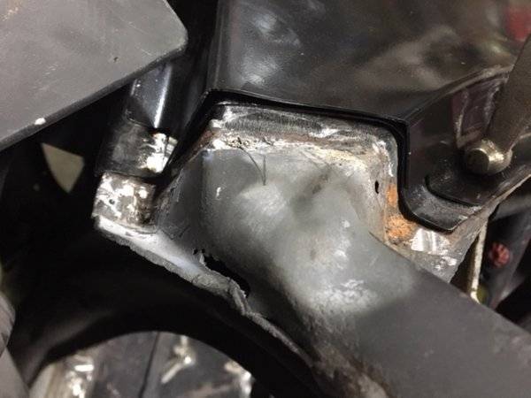

We found the left side is higher then the Door and Fender
It is physically higher. Thinking I could just cut it like I have to most of this China Sh%t I heard good things from AMD so I would reach out and see what they say
Quote - Just hammer it down! Really? and then he said its must off because the frame rail are not on the car yet? Really CLOWNS!!!!!
Im sure i still but more products from them but im sure going to rethink it!
This is the best they got for customer support???
Anybody had this??

All my AMD stuff fit perfect. Do you have the floor in the car still? If you have the frame rails and trans cross member out ?You may have some unibody twist. Are the doors gaps good? And do the doors still open and close nice?

If I had to guess I guess that you cut the old cowl off without slapping the new one over it first. The new cowls seem to be a tad shorter on the ends and that's part of the reason for your big gap. I think a small portion of the old one has to be left in place to butt weld to - just guessing because I cut mine off first too!!
Mine fits pretty damn good though. Keep in mind that there is and awful lot of lead in that area - mine was 1/4 to 3/8 thick in places.
