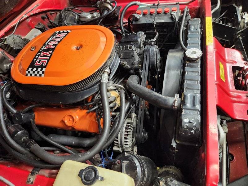

What heat resistant rattle can spray do you guys recommend for touching up my ‘71 383? Is there also a heat resistant aerosol primer as well? Engine looking a little shabby. Planning on an off season touching up and I really don’t want to pull the engine/trans so I’ll just remove accessories and mask off frame, etc. Thanks all.
