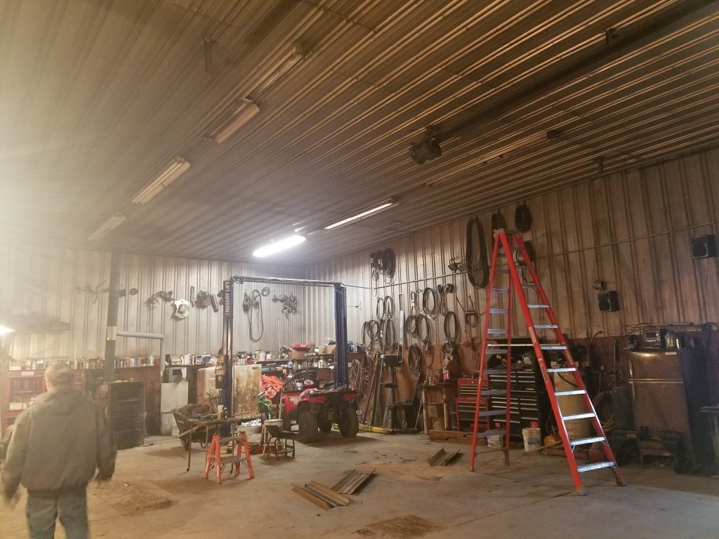

Re-lighting my shop. It's a 40' × 60' with a 15' ceiling. Built in '82 it's 6' fluorescent lights have become a nuisance. So after a few years of procrastination I decidedon't to do something about it. I borrowed a scissor lift to make it easier and got the removal and 2 of the 3 rows replaced today. (It's great to have a girlfriend who is secretary of a construction company.)
Before

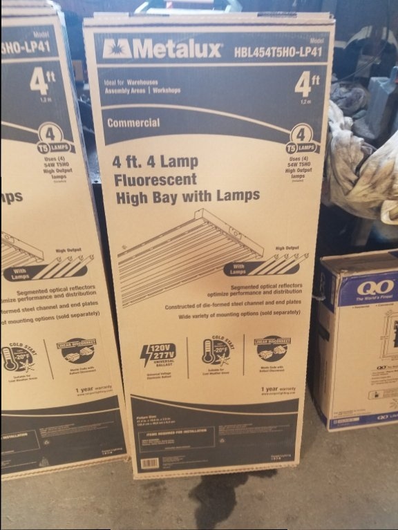

Replacement light

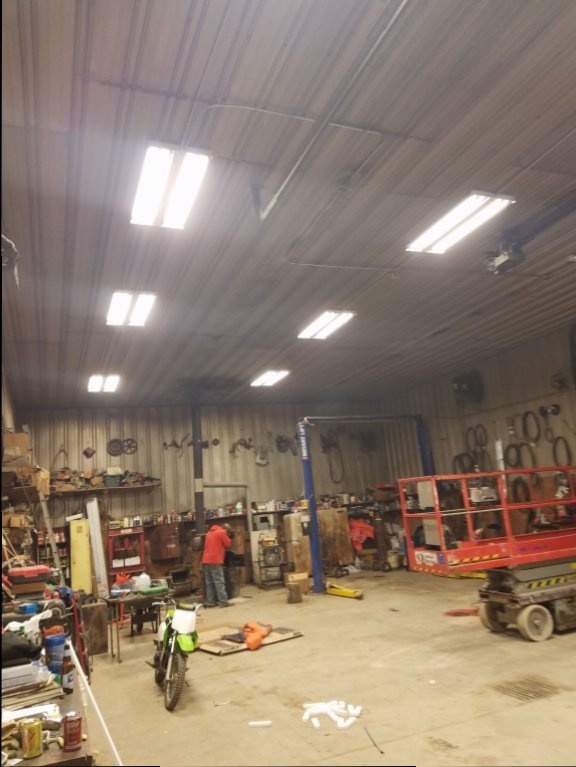

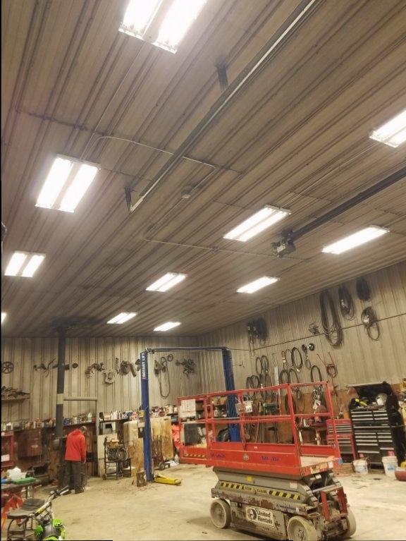

2/3 done. Will finish tomorrow and show pics
Those lights are the best when LED is out of your budget range. :thumbsup:
Nice job....you will get a ton more light than the old 6-footers.

Yeah theYeah were a pain in the ***. Ballast were going through a lot of bulbs.

Nice shop! Looks bright.
It was about like a dungeon. It was time to upgrade. I wanted to do it before I pull my car in to work on it for a month. I waited until I had maintenence all my equipment first.

T5 54w are the bomb....... those bulbs are 10 bucks each in home depot, I get a box of 25 from 1000bulbs.com for about 80 bucks shipped

T5HOs are a nice bright fluorescent. I retrofitted the entire factory with them that I used to work at. I found that they do have a few issues though.
They tend to heat up quite a bit, particularly at the sockets which can cause overheating related problems such as making the sockets brittle.
The thin tubes of T5s seem to flex more than T8 or T12, causing them to loosen and pull away resulting in flickering, etc.
We went through an enormous amount of ballasts for one of the fixture manufacturers we used. They had a defect that burned out an electronic component. Thankfully, this manufacturer had a 5 year warranty on them, but we still had to re&re all of them.
Avoid cheaper made in China fixtures. Like many things made from there, they are crap and may not last much past the warranty.
Havent had an ounce of issues w our t5's, going on 3 years. Love em!

The 8 ft t5s were 4 bulbs.
