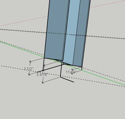

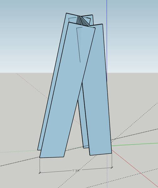

If you've ever used SketchUp . . . or some other design software, it's really pretty cool and can help out a TON during your designing stages . . .
Here's my thoughts . . .
Here's the end result that I'll need for the compound miters on the I-beam
The back two legs will be in the orientation . . .
But will have to be moved closer together until they "overlap" the give me the base with that I need for the stand . . . this is close - it needs to be about 12" . . .

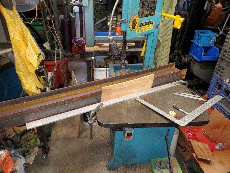

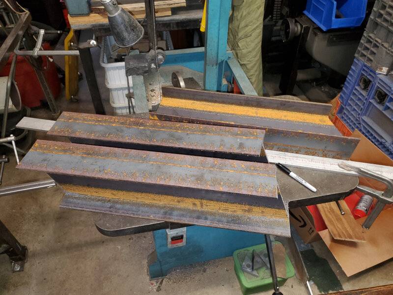

Time to start cutting some metal . . .

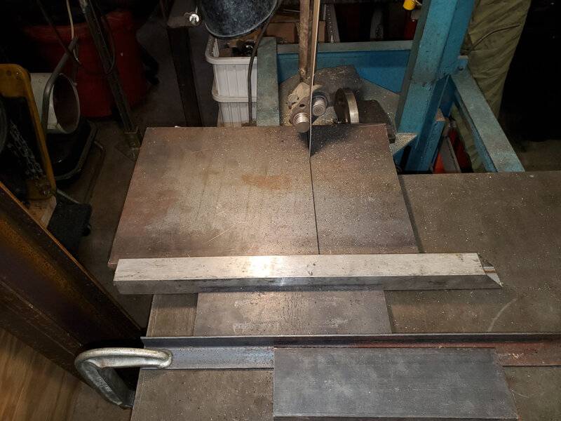

Picked up this piece of 3/4" plate and need to get it trimmed down to size for the anvil . . .

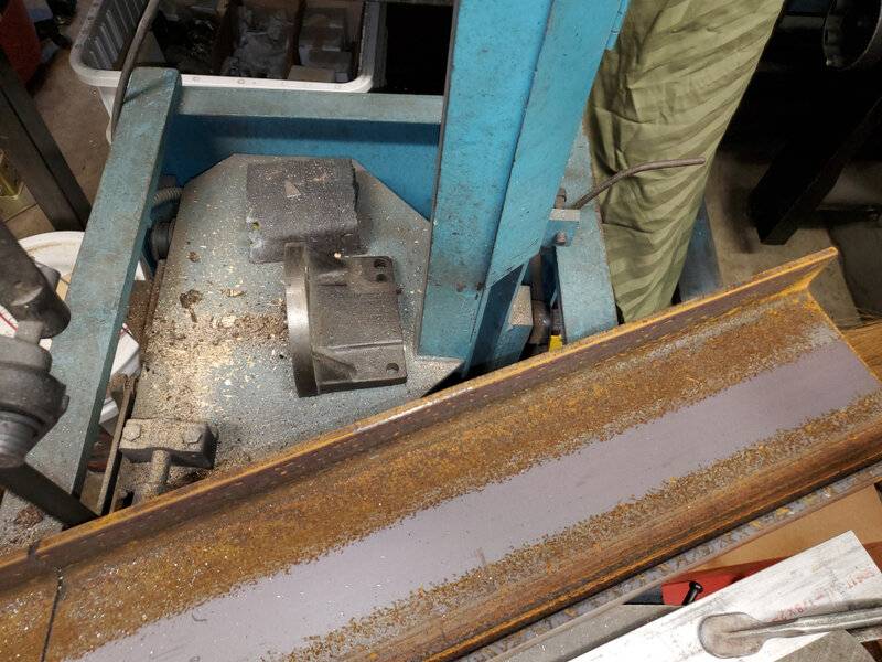

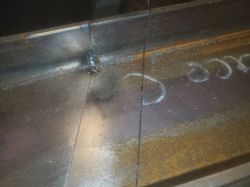

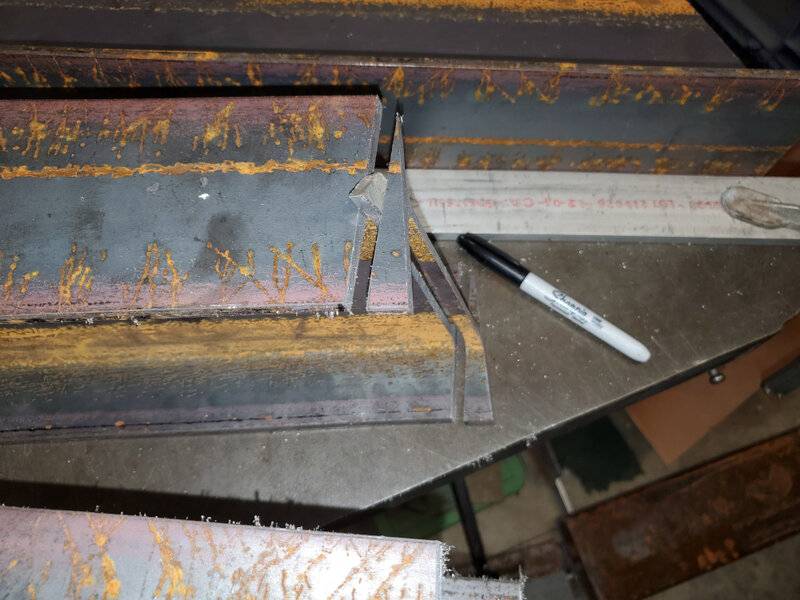

Then get started on cutting the 22 1/2 degree angles . . . thought I was "so clever" to get this set up like this - this is a fairly new saw for me . . . and I really like it . . .
Except . . . that I forgot that it slides . . . and it ended up hitting the I-beam ( gawd, I hate when I do that)
This is as far as I could go until I hit the beam . . . Argh . . . so now I have to flip it around the other direction, and "try" and line up the cuts . . . oh boy ! ! !
This took some time in my very cramped garage . . . seems like EVERYTHING was in the way and I had to move 4-5 things to get stuff out of the way, and then move more things, and then . . . they were STILL in the way . . . I NEED MY SHOP ! !
Plenty of room for clearance now . . . should not be a problem . . .
Not too shabby on the cut alignment either . . . there is a very small piece of metal in the very center of this pic to show the alignment . . .

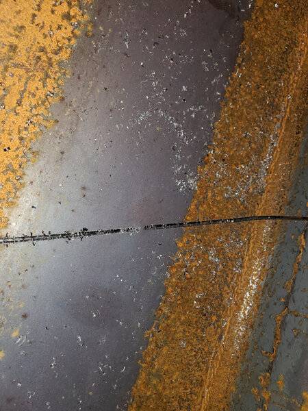

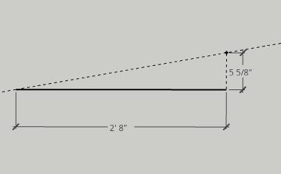

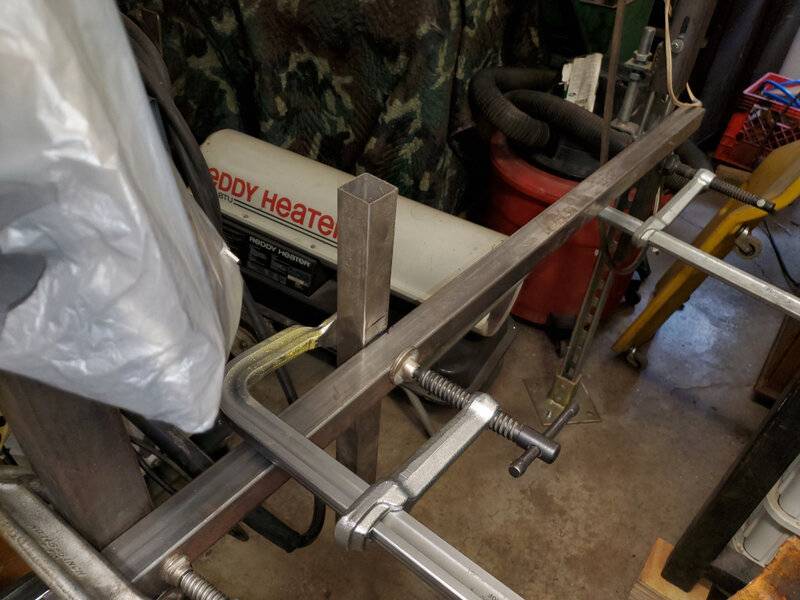

Here's one thing that I did - with SkecthUp to help with my compound angles . . . Had added a support to hold the overhand of the I-beam (had to)
So it was about 32" from the cut . . . so what "height" would I need at 32" to make my angle 10 degrees . . .
Laid it out with SketchUp . . . and got a height of 5 5/8" . . .
So a 5 5/8" support was clamped to the cross support - so I could get a measure . . .
Worked out great (of course I missed the picture with the sharpie line marked on it)
And this picture with the cutoff - you'll see that there is NO Sharpie lines visible - it hit it exactly !

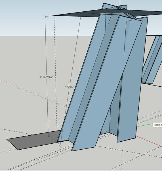

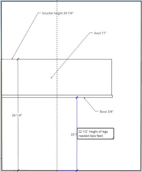

Here's my calculations for the height of the anvil base . . .
With your hand hanging normally, you mark where your knuckles are relaxed . . . that's 34 1/4" for me
Then the Anvil is 11" tall . . .
And then I've got the 3/4" base . . .
Which leaves a height of 22 1/2" . . . ( now here's where I was going to warn about getting the right measurement . . . )
GUESS WHO DID IT WRONG . . . Argh ! !
And had to do some "metal Stretching" . . . to be able to make it all work
( and I had PLENTY of extra I-beam . . . just forgot about the angle making the pieces LONGER . . .
So I set up the saw to re-cut the stretched metal . . . and I did THAT wrong (again) and it hit the I-beam 1/2 way through the cut . . .
SO I had to flip it over (again) and try and match up the cuts . . . again, not too shabby . . .
So my required 22 1/2" . . . on this it's showing 1' 10 7/16" . . . missed my point but didn't want to spent time finding the error for this demo.
The length of the leg needed is showing 24 5/16" . . . 2 additional inches . . .
So . . . I ended up having to stretch the metal . . .

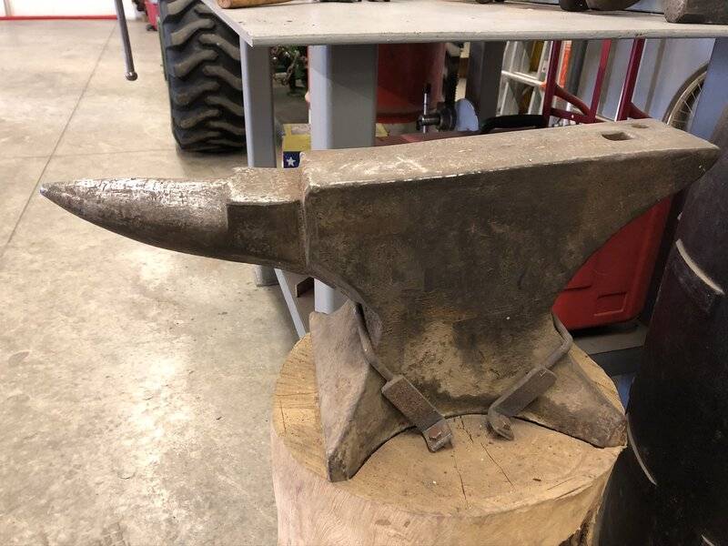

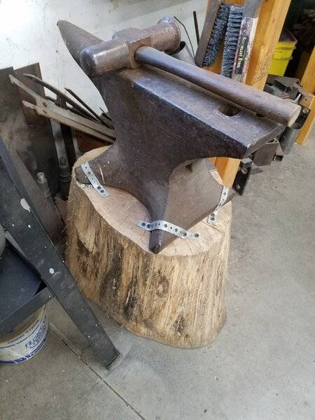

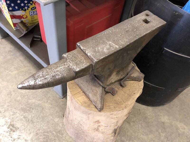

Here is my anvil on a chunk of ash. I wish the top was in better shape, somebody evidently used it to beat cold steel. I had it on a steel stand before I put it on wood, my experience with steel is that the anvil bounced too much when you hit anything on it.
Which leaves a height of 22 1/2" . . . ( now here's where I was going to war about getting the right measurement . . . )

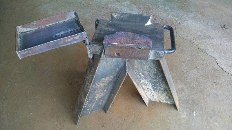

View attachment 1102133 View attachment 1102134
Lol, we think a lot alike. Mine is a chunk of oak though. I like your hold down straps better than mine, I'll have to make some like that. I kind of like it mounted on wood, especially because of how it deadens the sound when banging on it.
My anvil was originally mounted to a piece of very large I beam, not the most stable stand, when you struck the anvil it would bounce. One time I hit it so hard that it fell over onto my foot. I thought I broke it, ended up in the emergency room, found out it wasn’t broken, just a bad bruise. When I told the ER nurse that I dropped an anvil on it, she asked me if I was chasing a road runner at the time! Nothing like a little ER humor. :D
Hard to beat a big chunk of log.. and it only requires a chainsaw to build:thumbsup:

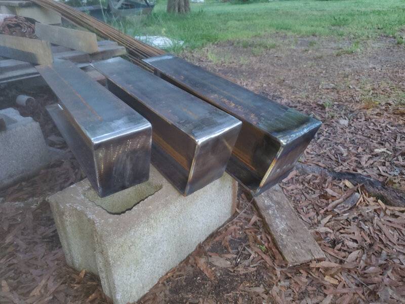

So much fun doing things the second time around . . . got all of the feet fixed due to my miscalculation . .

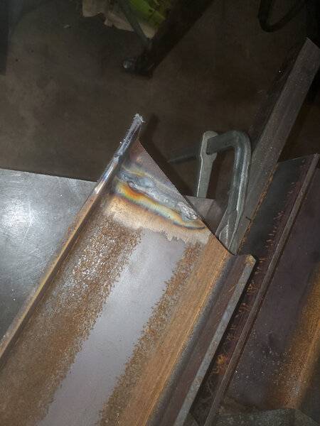

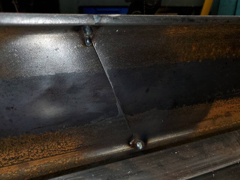

Pulled out the TIG welder to get some practice with it . . . going to figure that thing out one day . . .
Feel like I'm actually getting the hang of it . . . and now I understand a water cooled torch ! !
Also will be adding bottoms on the feet - really like the way it finishes off the leg . . .
More work left . . .
Mine's on a 30" diameter log, it's sturdy and deadens the sound. But if you're using metal you can place either a piece of heavy rubber (like conveyor belt) or plywood shim under the anvil to help muffle the ringing.

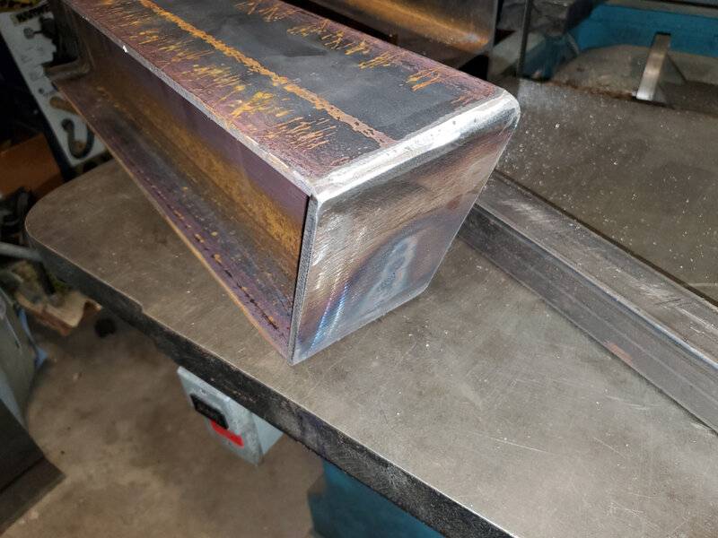

Got the bases welded onto the feet . . . well . . . sorta . . . and the TIG welding got much better . . .
The helmet started blinking that the battery was low, so I had to run around and find new batteries . . . that took a while . . . but glad to have new batteries in the helmet now.
Here's what I've got now . . .
The far left one is the front foot . . .
The other two are the rear feet . . . and I welded them so that the "patches" were on the top . . .

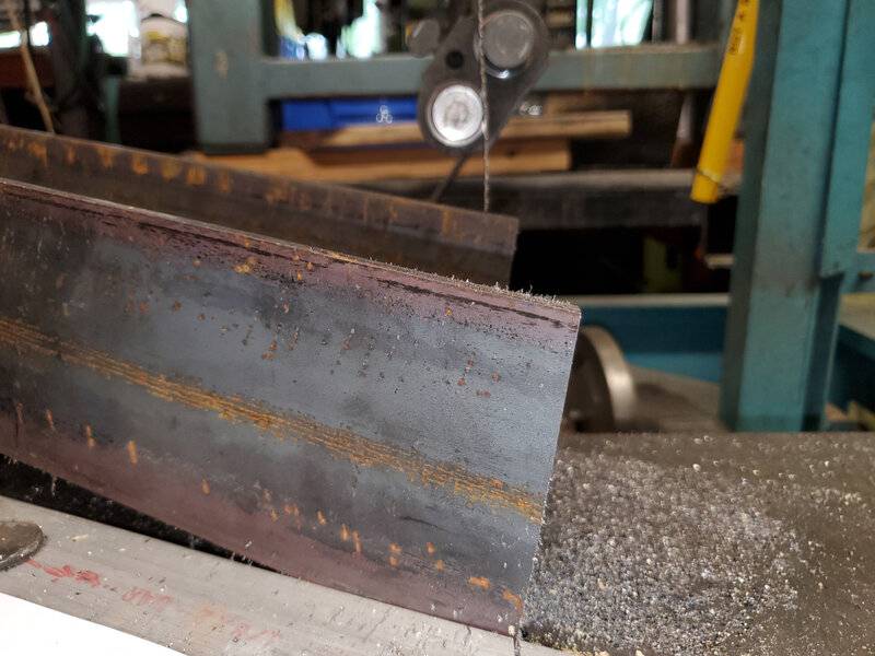

One Problem . . . both cuts were done the same way on the bandsaw . . . so . . .
Now got two rear feet the lean right, instead of one right and one left . . . ARGH ! ! !
I can fix that . . . just get to do it all over again . . . story of my life . . .
