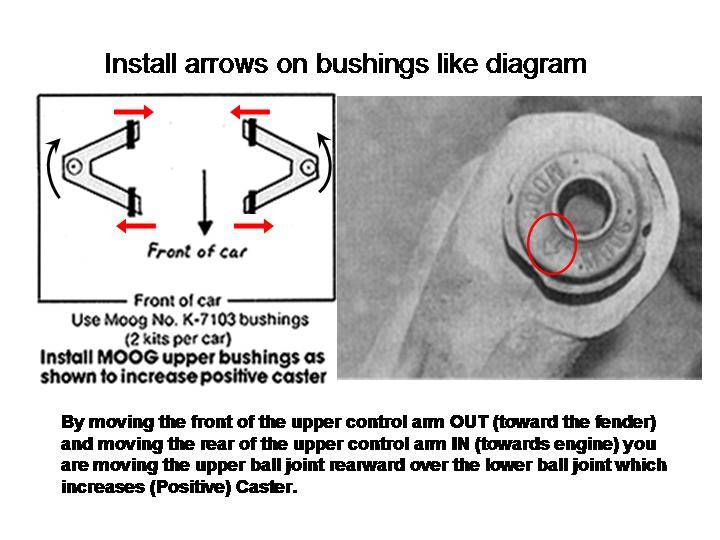

In most of the Mopars that I have owned and read about, getting a lot of caster is difficult even in cars without bent parts or previous damage. Caster really helps stability.
I asked the man to set it to .75 degree of NEGative camber, 1/8" toe IN and as much caster as possible.
The last time, he was able to get barely over 4 degrees of caster. This time he got 5 on the left and 5.5 on the right.
This is with stock upper control arms but with the Moog K-7103 offset UCA bushings.
This is the most caster that I have ever heard of with stock parts.

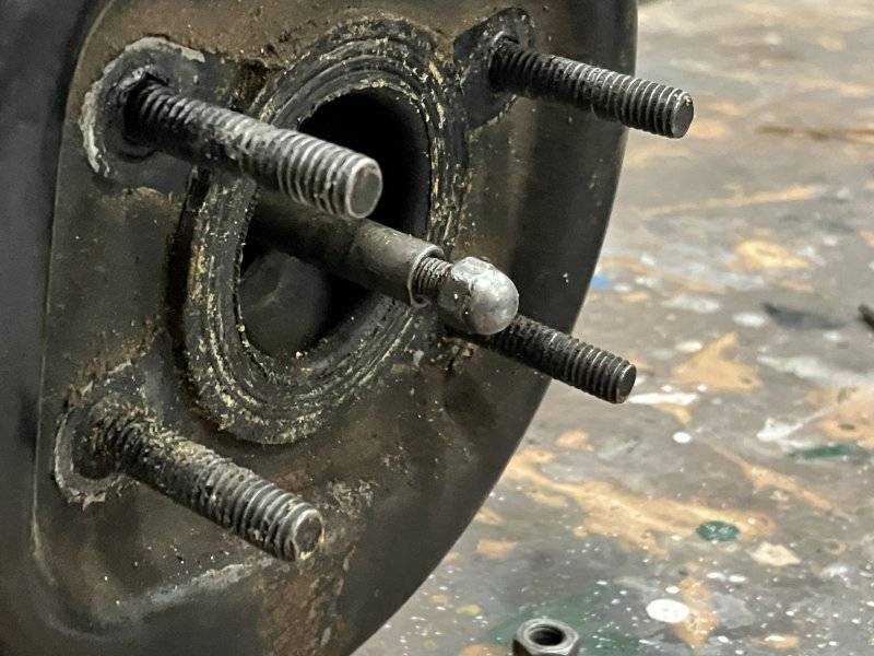

The brakes feel decent but still not enough for me to consider them finished. The pedal travel has increased a bit since I did the last work on them. They bite but the pedal sinks further than I'd prefer. The booster has a rod with an adjustable nub on the end that can be unscrewed to close up the dead travel:

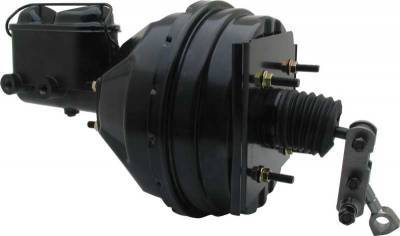

Currently, mine is bottomed out and could be extended to close the gap a bit but since I can't seem to leave this alone, I'm wondering if this single diaphragm 8 3/4" booster is enough for the system and weight of the car.
66-70 B body cars used this style booster:
Dual diaphragm for double the assist. I interpret this to mean less effort needed to stop as compared to the single diaphragm booster OR greater stopping force using the same pedal pressure.

The setup that I have in place does work but pedal travel free play is more than I'd like. When the brakes start to grab, they seem fine but not excellent.
The dual diaphragm booster should provide more assist and a bigger bore master cylinder should shorten the pedal stroke. In theory, this should result in similar pedal effort with less pedal travel.

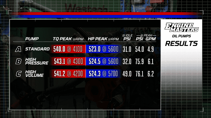

I'm a bit curious about the oil pressure. Cold idle is about 50 psi but drops a lot once the engine warms up.
This is the first time I have used a standard volume oil pump in a big block. I read that most street engines do not need the higher output that the HV pumps provide and that the HV just wastes HP.

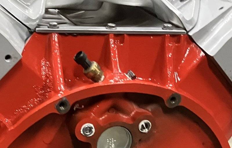

Big question.... Do you trust the gauge?
Rods are still where they belong? You're probably fine...
Oh yeah. On the inside swinging around as they should. I may be worrying about a non-issue.
I could plumb in a mechanical gauge.
