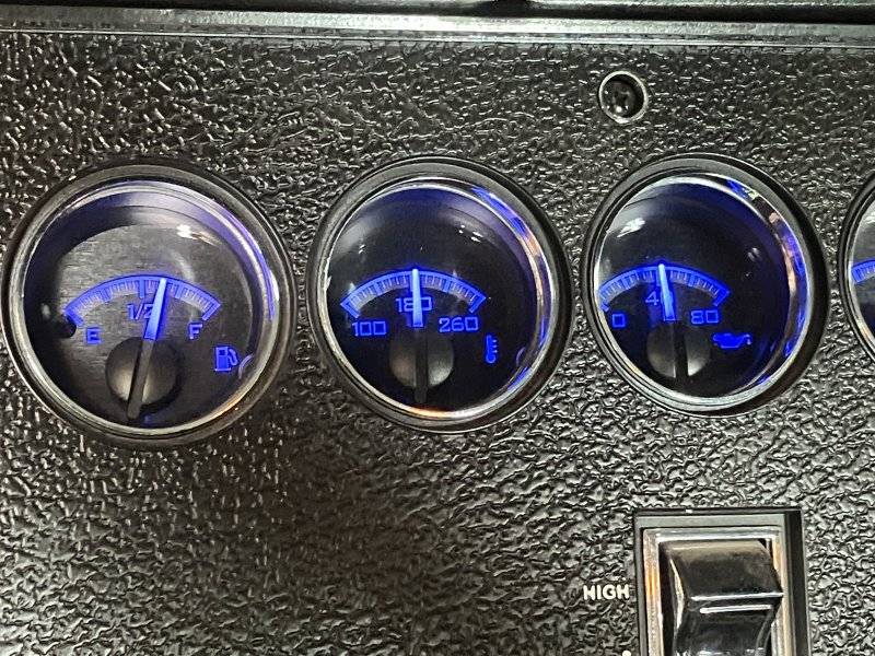

Warmed up a little bit.

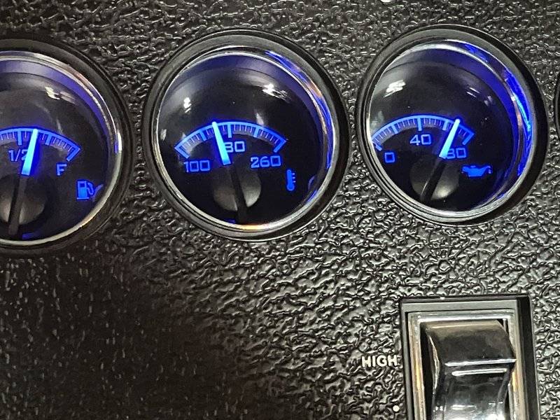

Now at operating temperature. Forgive the blur… the phone was touching the steering wheel and it vibrates a bit.
It drops below 40 but on the road at idle it hovers around 20.

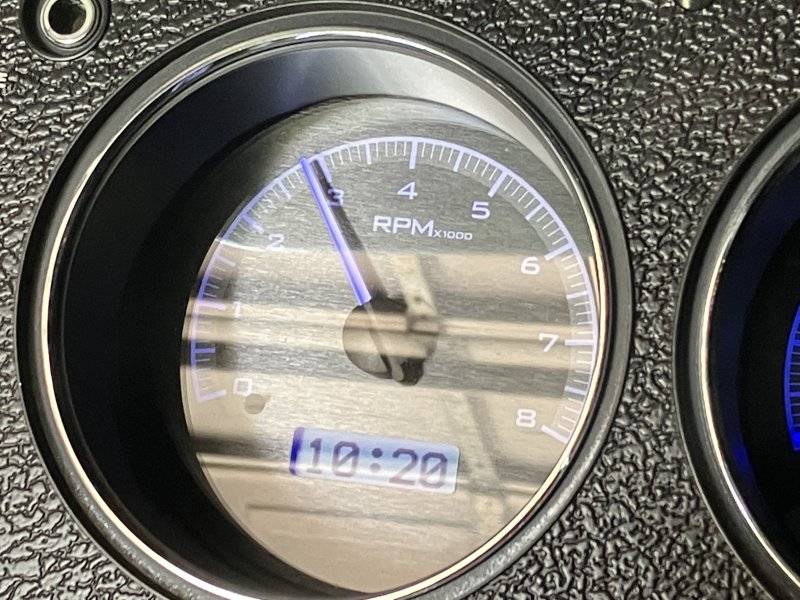

At speed:

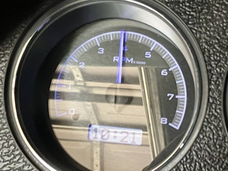

Over 50 at 3000 is okay but then….
By 4000 it is maybe 55? It peaks there. Pressure didn’t go any higher when I pushed to 5000 rpms.
