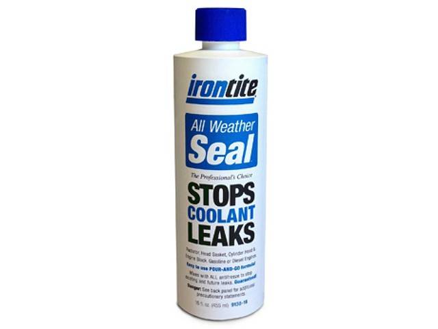

If you insert a stud and it still leaks, well...
This stuff plugged up a leaky head gasket on a neon I once drove. Saved me a lot of work.
