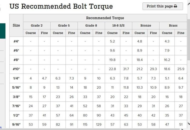

Torque on clutch cover 3/8's bolt takes in SM is 30 foot lbs.. This bolt torque chart grade 8 thkes 33 foot lbs and grade 5 takes 23 foot lbs both course thread. So I'd say grade 8 for clutch cover.
