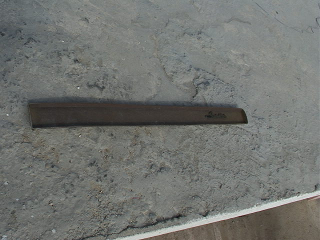

My 72 SSP plastic imitation wood panel with "Satellite" logo is warped. I wonder if a carpenter/furniture maker could make me another one, but using real wood. Maybe walnut? Anybody try this before me?

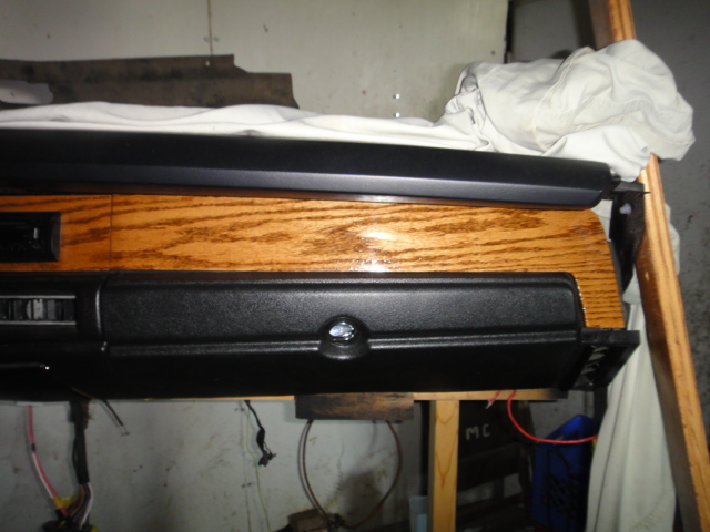

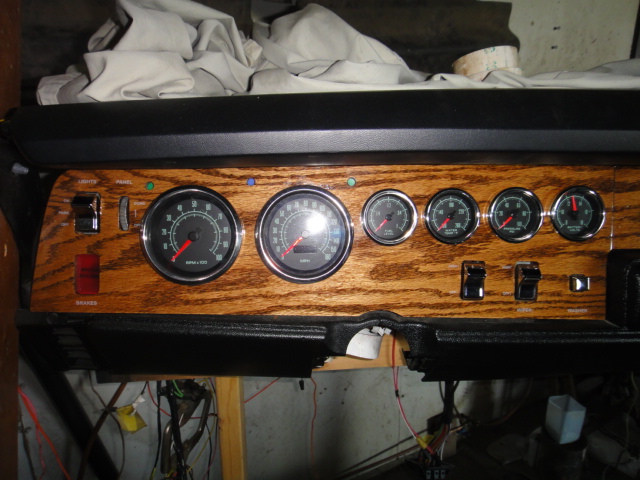

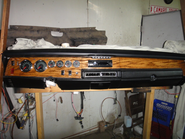

My dash. 3/4" white oak.

Hawkeye, looks great. Has it been installed long enough to evaluate the fears of deterioration? (cracks, warps, termite-Oh no!)
It has only been on for about 4 months. I put 4 coats of stain/sealer and 10 coats of polyurethane. Time will tell.
Very nice.I'm envious of your work there.
Hope you put a sealer on the back and edges as well. When putting cedar on my house, it was highly recommended that I seal on all sides or the wood would absorb moisture from the air and warp/crack no matter how well the front side looked. That was the reason all my wood on house was curled up, cracked and pulled through the nails. Just my thoughts.
