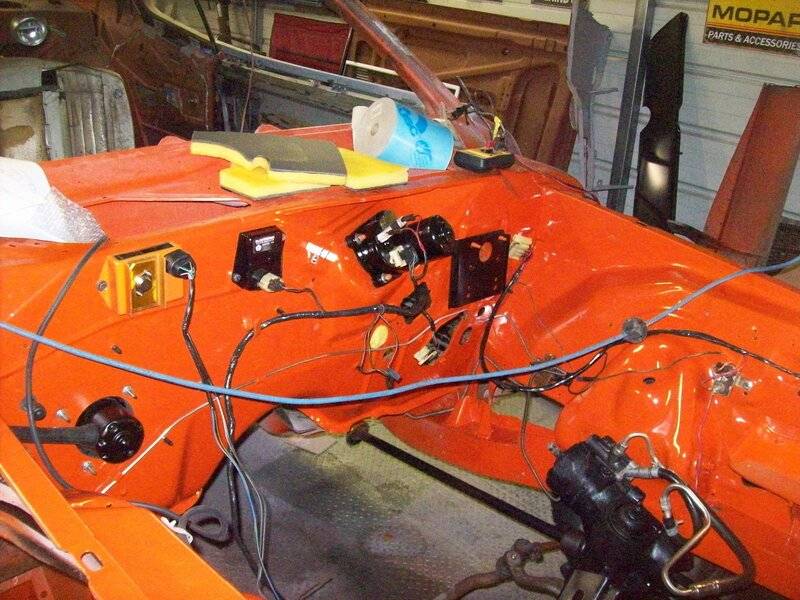

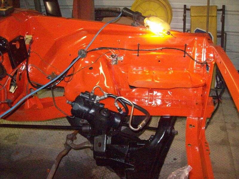

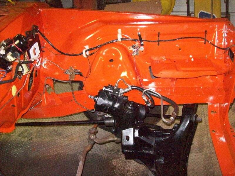

Hi all, new to FBBO. I like the site and it is very informative. I have a 71 Road Runner with factory 11x3/11x2.5 manual drum brakes. My rear brakes get very hot after a short drive. Been this way ever since I had the car on the road. I backed off on the rear adjustment and this helps some what. The e-brake adjustment is very loose and the function is good. My system only has a distribution block with warning light terminal. All parts are new on this car except this block. I am wondering if maybe the valve in the block might be stuck and is blocking fluid to the front brakes. The fronts do work if I jack the front up and spin the wheel. But I can't tell how much I am getting under load. Overall, the car does not have a lot of braking power. Is there a way I can tell if my valve is off center? (the light on the dash is not lit) included are pics from when I built the car.
