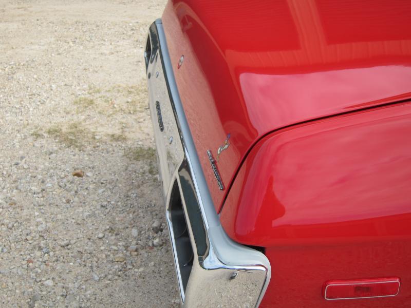

it's been a couple of years but if i remember correctly my filler just slipped over the Bumper lip with the Trunk open. No adhesive used however i have to check it every now and then to make sure it hasn't slipped off. Texas heat also makes it soft during the summer.View attachment IMG_0434.jpg

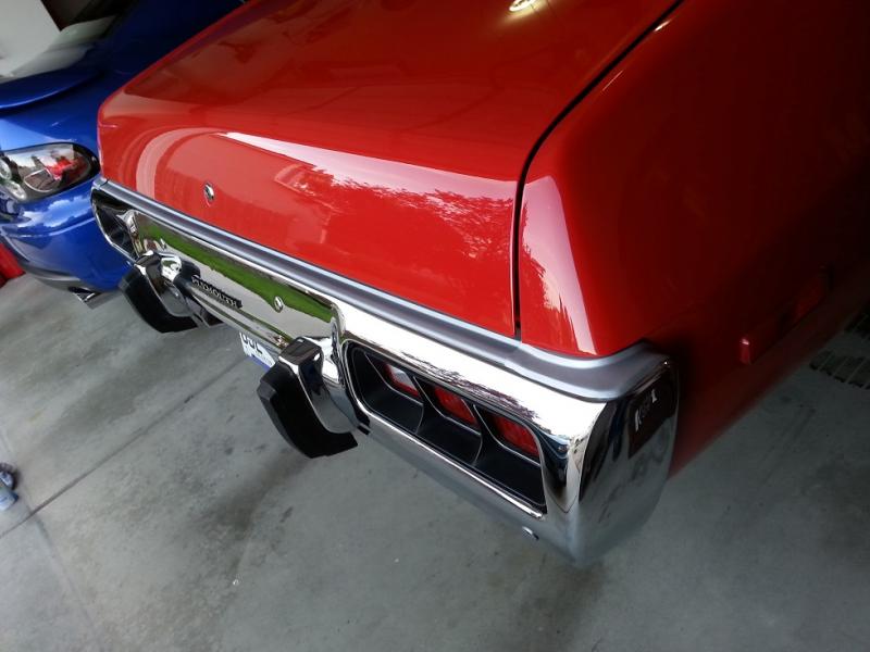

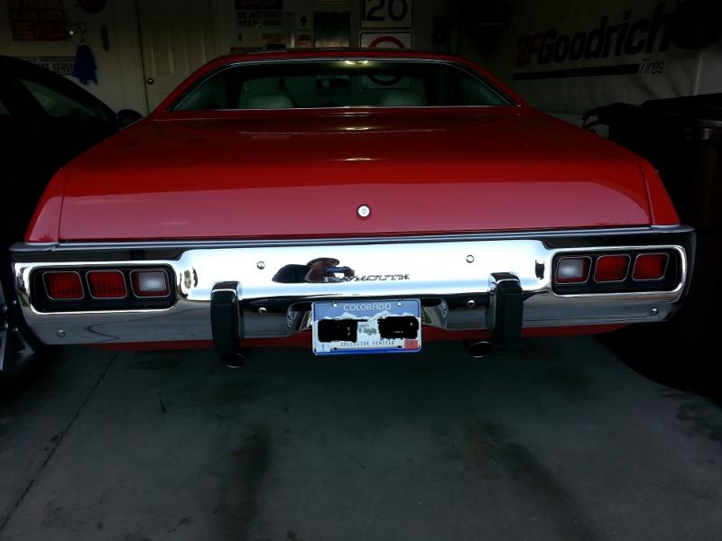

Well, I got mine installed, used 3m super adhesive double sided tape. We shall see how long that lasts, was recommended by the vendor to use.
Here is what she looks like.
What is the bad image in the rear bumper :icon_fU:
looks great better than when it was new
it's been a couple of years but if i remember correctly my filler just slipped over the Bumper lip with the Trunk open. No adhesive used however i have to check it every now and then to make sure it hasn't slipped off. Texas heat also makes it soft during the summer.View attachment 187866
Ditto.
Looks like your bumper may be out too far. The center filler should be touching the end of the trunk outer lip and works to hold it in.

So the originals were held n place because they had a piece of spring metal that ran the distance of the gap that slid over the bumper. New reproductions don't have that and the guys that make them also told me if the bumper was rechromed theirs don't stay in place because the bumper is thicker and recommend using double sided tape. So mine doesn't touch the trunk lip either. There's about a quarter inch gap. So this will have to do for now until or if someone makes a better one.
