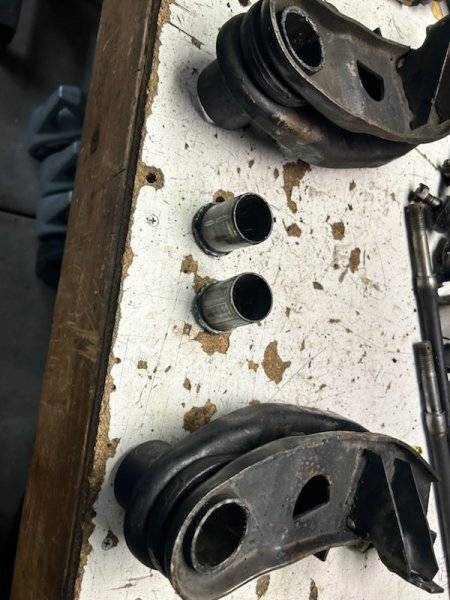

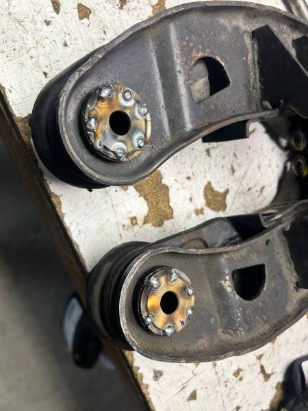

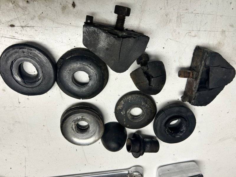

Look at all this carnage -

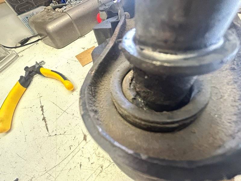

This is the drivers lower bushing, the passenger side was not nearly as bad.

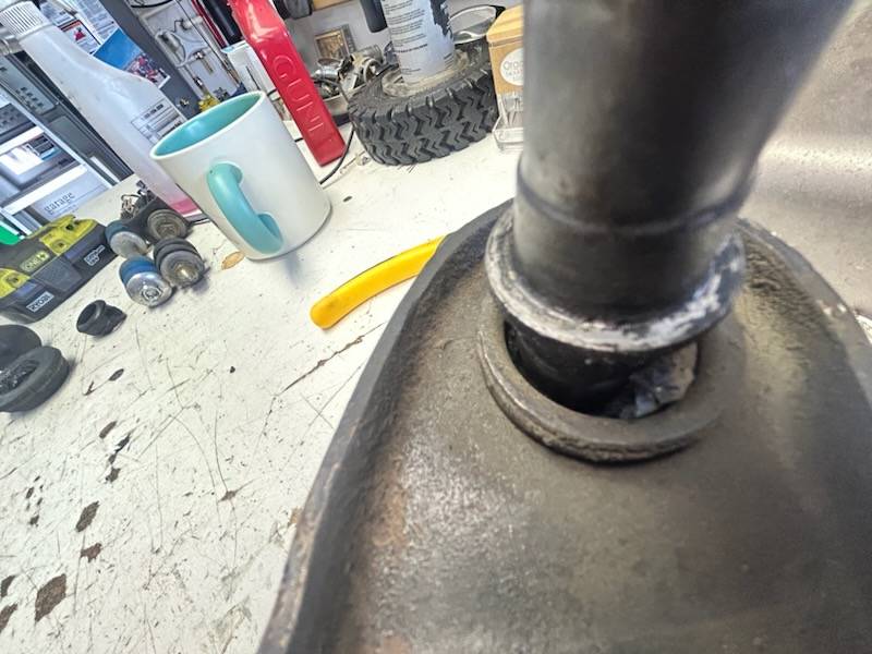

A little cleanup on the drivers side

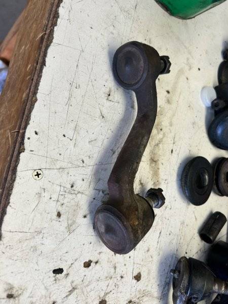

This is the idler arm off the car, there are no grease fittings. Could this be the original? Unbelievably it is still very tight too!

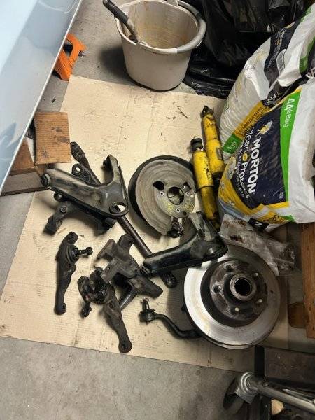

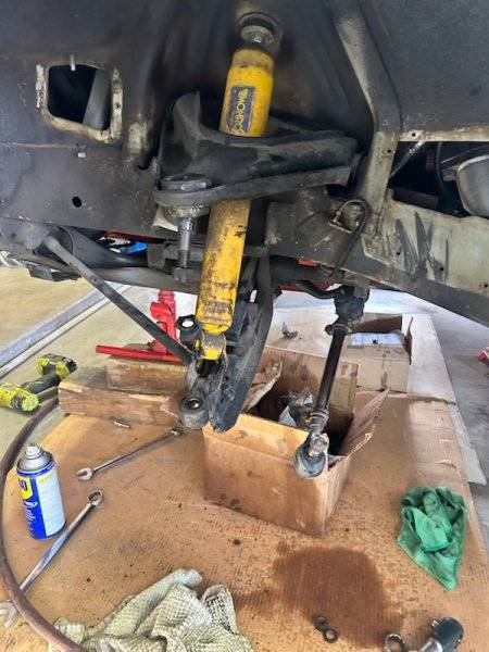

Dissasembly - turns out the front shocks are done-in unlike the rears. Gonna put KYB's on it.
As you can see in the pictures the control arms, spindles & struts are all painted black. So somebody was in here previously. I'm pretty sure it was my dad, he was a penny pincher so he probably only replaced what was needed, usually the bushings and lower ball joints & maybe a couple tie rod ends. This time it wll get all new NORS USA made ball joints, pitman, idler, rod ends, upgraded (newer design) strut bushings and control arm bushings. New bump stops too cause they are trashed.

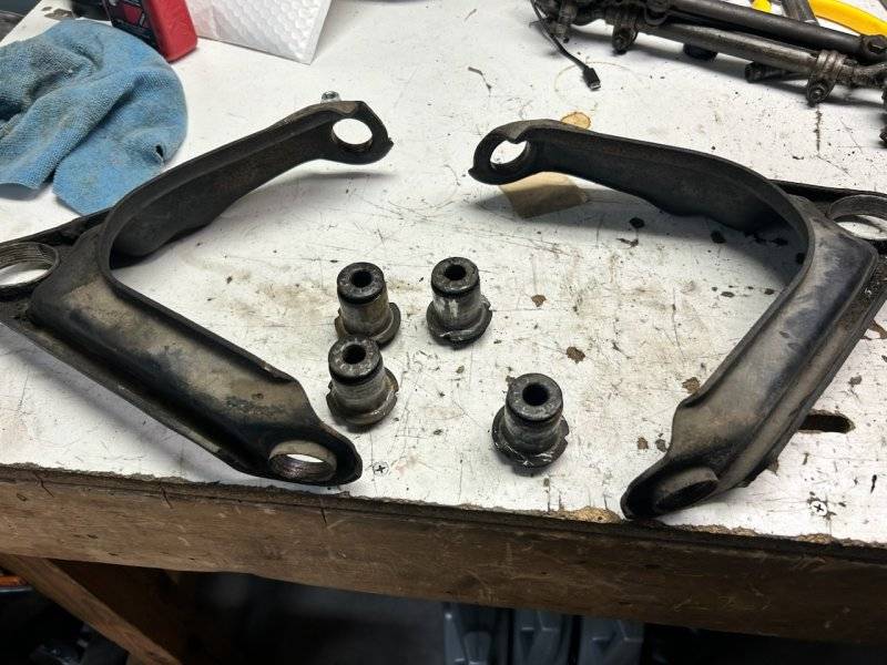

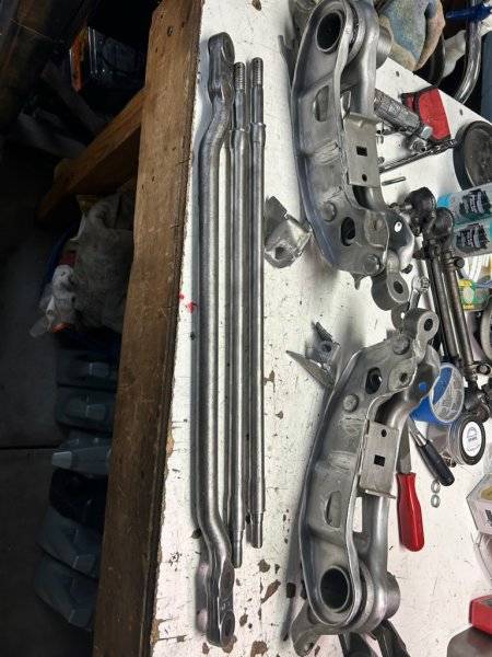

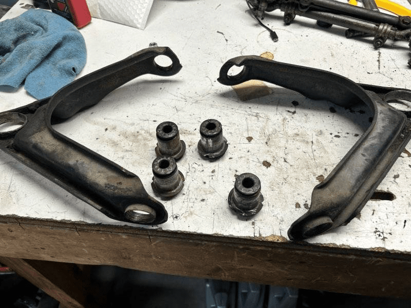

Back at it, more fun stuff . . . cleaning parts. Step 1 - clean off oil, grease & dirt. Step 2 - remove old paint with paint remover. Step 3 - soak parts in my vinnegar, lemon juice & salt soup.

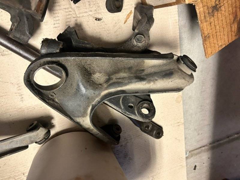

Upper control arms before -
And after - now ready for new bushings, ball joints and fresh paint -

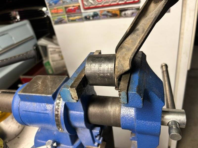

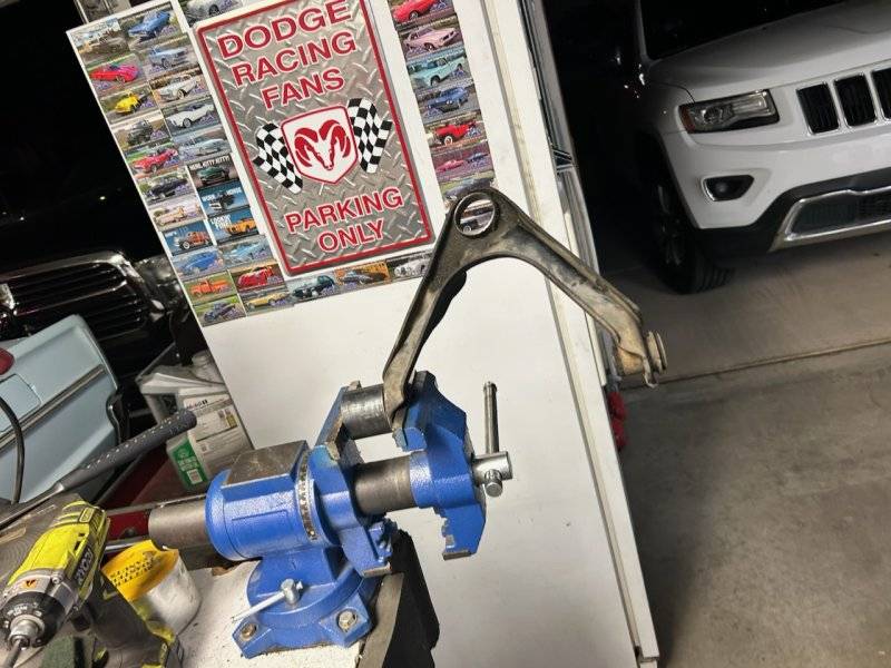

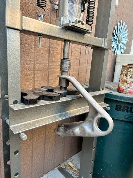

Pressing in the new bushings -

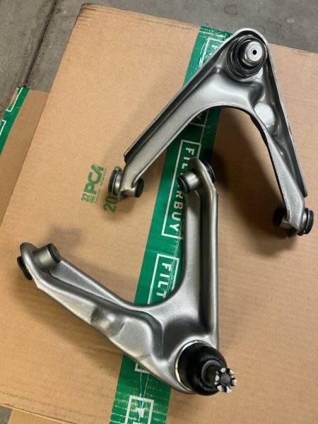

New ball joints installed and a-arms painted. On to the next phase -

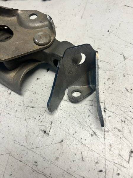

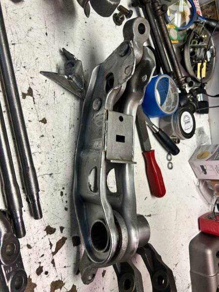

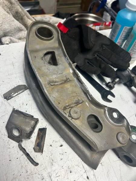

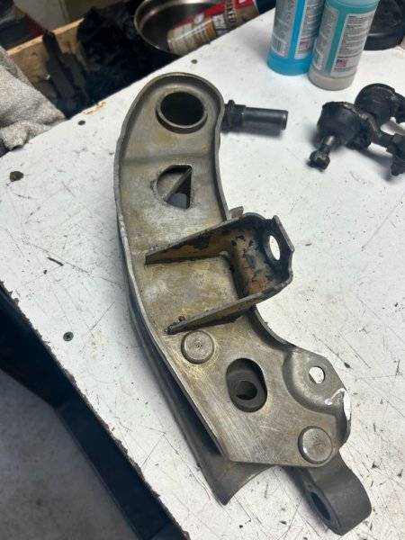

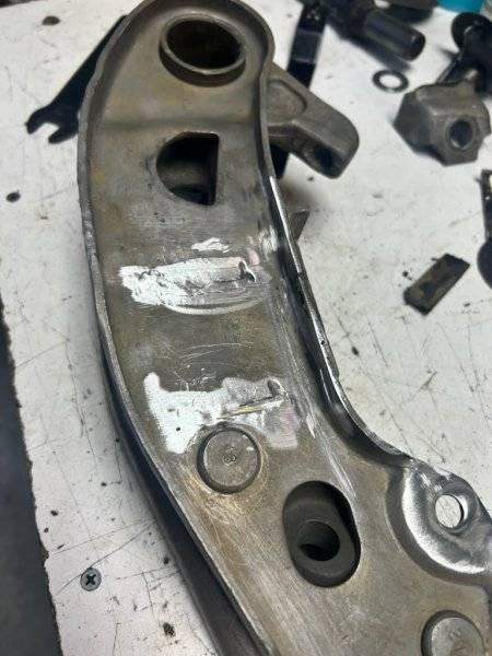

I'm going to upgrade to a bigger sway bar for this car. I got a good price on a used Summit 1 1/8 sway bar for it but my lower control arms have the link brackets in the wrong spot. I wish I could just swap control arms from my other '66 Coronet (it has the correct brackets) but that would be way too much work. After I got the drivers side control arm cleaned up it was time for modifications - cut old one off.
I bought these brackets from Hotchkis - all I need to do now is weld it on.

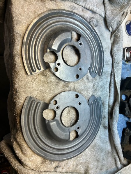

More cleaning - dust shields, I was surprised to see they were galvanized. Not a spec of rust on them after 52 years, they were very dirty though. You can also see it the pic that they have that wrecking yard yellow paint pen writing on them . . . apparently these came off a '73 Satellite. My dad converted this car to disc brakes sometime between 1976 & 1980 - I believe he may have been one of the very first people to do this. At that time he had easy access to the parts because he managed a wrecking yard. It was called Thomas Auto Wreckers, located in Duarte Calfornia. Any of you SoCal guys know the place? No doubt he got the set up off a wrecked car from the yard.
And the cleaning continues - All these parts are down to bare metal - next step prep & paint.
I have removed the old sway bar link brackets, prepped & fitted the new brackets. Next is to weld them on and paint.

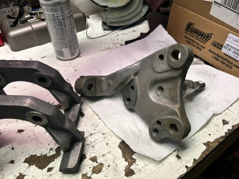

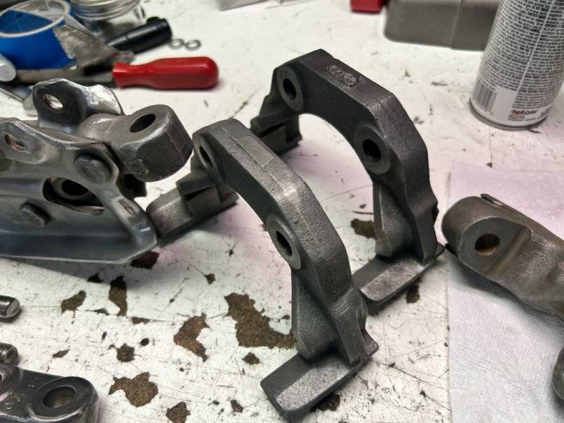

Spindles ready, I bolted on the caliper brackets and painted them Eastwood cast iron grey.
Splash shields ready, painted Duplicolor cast aluminum -
