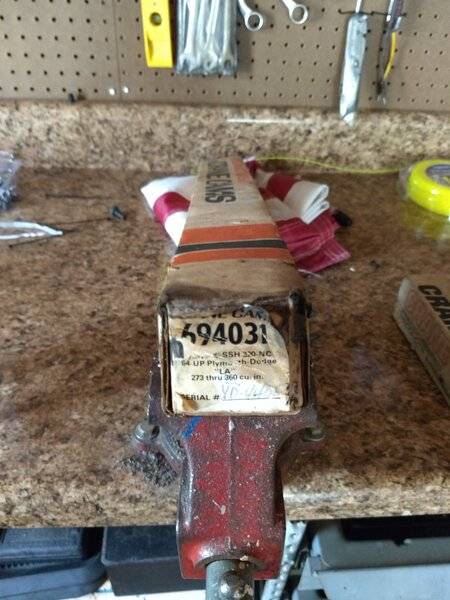

Mistake on my part. The carb is a 600 not 650 and not a DP. The carb that was on it was a DP 750. I also have the original carb which was a 2 barrel. Tks. for t It has the original dual exhaust manifolds, so no headers. Not sure how aggressive the cam is but here is but here is a photo of the crane cam with part # that was installed. I will admit i do not know much of anything about cams. Tks. for the help and info.
If this is the right cam card for what you posted, this is not a good cam for you. If you want to make life better, get a new cam
Even at 0.005' or 0.006" lift, this cam will still have a comparable advertised duration of 300°/310°. And even on a 114° LSA it will still have +70° overlap. Couldn't think of a worse cam for your application, with exhaust manifolds making it worse yet.

Agree, even with the correct matching components the card says recommended RPM range is 3200 to 6200 RPM. Terrible for a stock 318. Stay closer to a stock 340 cam if you must. Even then...

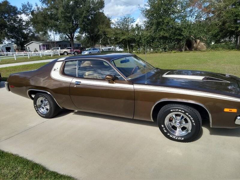

I have purchased a 1974 Roadrunner about 2 years ago. It was an original automatic and had been switched to a 4 speed. An agressive cam had been installed as well as a dual double pumper carburetor. It has a 318 engine. When i got the car it had 323 rear end gears and was extremely sluggish when taking off in 1st gear, sometimes even stalling out. Moving today, i had 373 gears installed and was still a little sluggish. Future investigation it was thought the carb was way to big for the engine, so i installed a new holly 650. All issues resolved. Problem now is at 45 mph in 4th gear the engine is running at about 3100 rpm. Sounds like it going to come out from under the hood. Any suggestions to lowering the rpm. Should i go back to 323 or even mayby 273?
