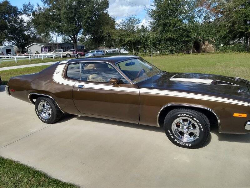

I have purchased a 1974 Roadrunner about 2 years ago. It was an original automatic and had been switched to a 4 speed. An agressive cam had been installed as well as a dual double pumper carburetor. It has a 318 engine. When i got the car it had 323 rear end gears and was extremely sluggish when taking off in 1st gear, sometimes even stalling out. Moving today, i had 373 gears installed and was still a little sluggish. Future investigation it was thought the carb was way to big for the engine, so i installed a new holly 650. All issues resolved. Problem now is at 45 mph in 4th gear the engine is running at about 3100 rpm. Sounds like it going to come out from under the hood. Any suggestions to lowering the rpm. Should i go back to 323 or even mayby 273?

First what are the types of driving you normally do ? The 3.73 will keep it fun unless you drive mostly highway and not many secondary roads.You can try to tame it down a bit by adjusting the rear tire height.Looking at your photo I will guess a height of 26'' You may want to try 28'' or my preference a 30'' tire height.
