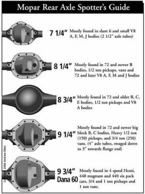

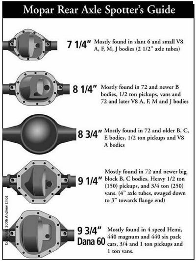

The easiest way to identify an axle is to look at the cover on the carrier housing:
7-1/4" has a 9 bolt rear cover.
8-1/4" has 10 bolts, evenly spaced. The cover is almost perfectly round.
8-3/4" has no rear cover. The back of the axle housing is round. The center section is removable from the front of the housing.
9-1/4" has a 12 bolt rear cover. Rear cover is roughly octagonal (stop sign-shaped).
9-3/4" has a 10 bolt rear cover. The cover is wider on the driver side.
Judging from the picture guide above, it is an 8-3/4. It's round on the rear side, with no removable cover. The cover is on the front side, towards the drive shaft. Thanks, you guys are awesome!
