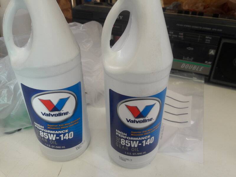

I used 85w140 per the diff shop recommendation. Took 9 pints total and I've checked the level twice.
