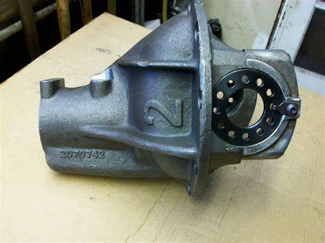

Yes there is a LARGE number cast on the drivers side of the carrier, filler plug on pass side. Look for X and 1 are 741, the a 2, 9, or Yukon has a letter Y there.

Also the front of the case where the bearing goes is largest on a #2 because it has the largest front pinion bearing. So the seal is larger. #1 and 9 use the same pinion seal. So the dust shield on a #2 yoke is bigger than 1 and 9. Ever have a dust shield rub the case on a #2? when swapping yokes? I have.

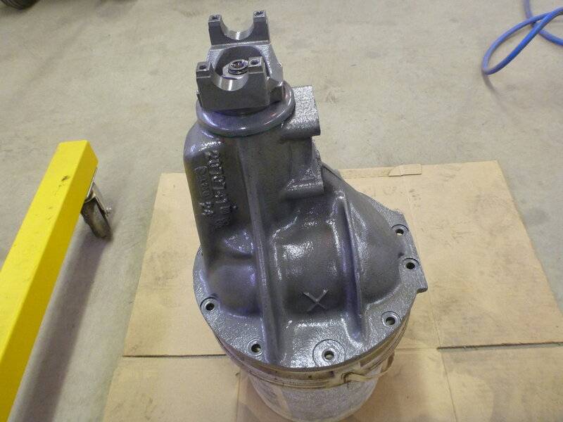

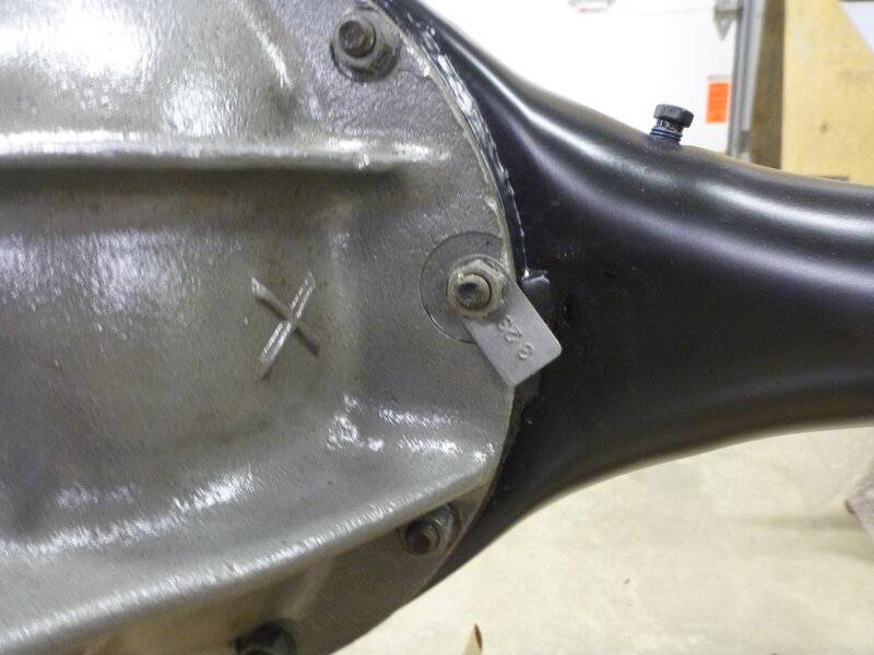

There is undercoating all over the rear but a can see a small "x" on that side of the housing, perhaps an inch or so in size, so looks like this is a 741....
My 741 case has a x about an inch in size, cast onto the case between the ribs. Pretty sure you are correct, youve got a 741, especially if originally a 318 car.
(And i personally think there is nothing wrong with a 741, an unfair rep for being weak.)

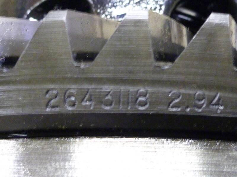

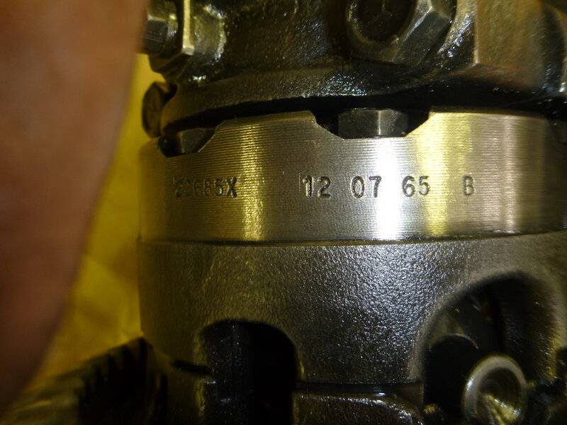

741 in my Bee. It's a '66 from a Charger. 2.94 would be your ratio.. not 2.93. That is what mine is, even though I have it tagged 3.23 to what OE would have been.
