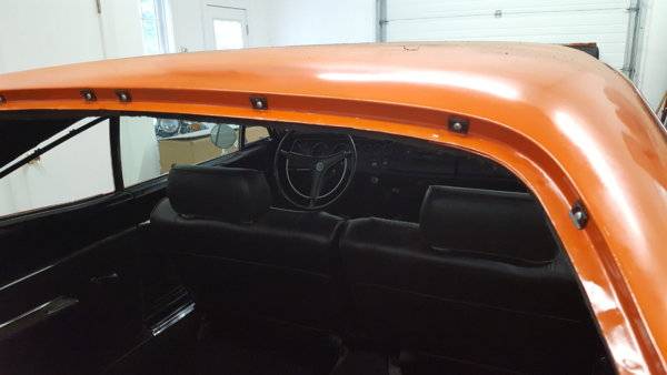

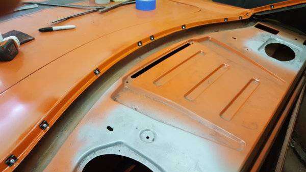

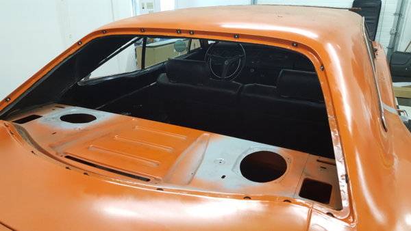

Good afternoon all,
I am in the process of installing the rear glass in my 1969 Superbee. Due to various metal replacement and rust hole cover-ups by previous owner, I cannot locate the proper placement for these clips. Could anyone post a photo of their project showing the placement of these items or offer any guidance on where to drill the holes?
I would appreciate any guidance offered.
Thank you,
Ben
Here are some pics of my 69 'Bee. I am almost positive that there are at least 2 too many reveal clips than there are supposed to be. Somewhere along the way, extras must have been added to help keep the trim in place. In the first photo, the only clips not installed are the middle clips along the left and right sides. They got added after the photo was taken and I did not take any after. Maybe another member can identify exactly which clips do not belong. I just installed as many clips as there were existing holes but most of them are correct and should at least give you a jumping-off point. Hope this helps...
Thanks a bunch for these photos! I appreciate your help! I got all of the clips in, now I just need to finish cleaning 50 years of dirt off the glass.
