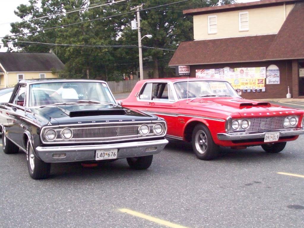

Any car sits a bit crooked when you put the SS springs on but all you have to do is adjust the torsion bars to fix it. I have done it a ton of times and I always adjust the torsion bars and they all sit level when I am done. I put SS springs on my 63 and my buddies 65 you see here. As you can see they look pretty level sitting to me. Ron
