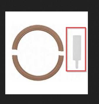

BTW what is this thing for?
that is used if crank is already in the block,the small end goes between block and seal so the seals backside isn't cut rotating the seal in the block.
hm so with that thing i can change a seal without taking out the crank?
thats great good to know that, thx
