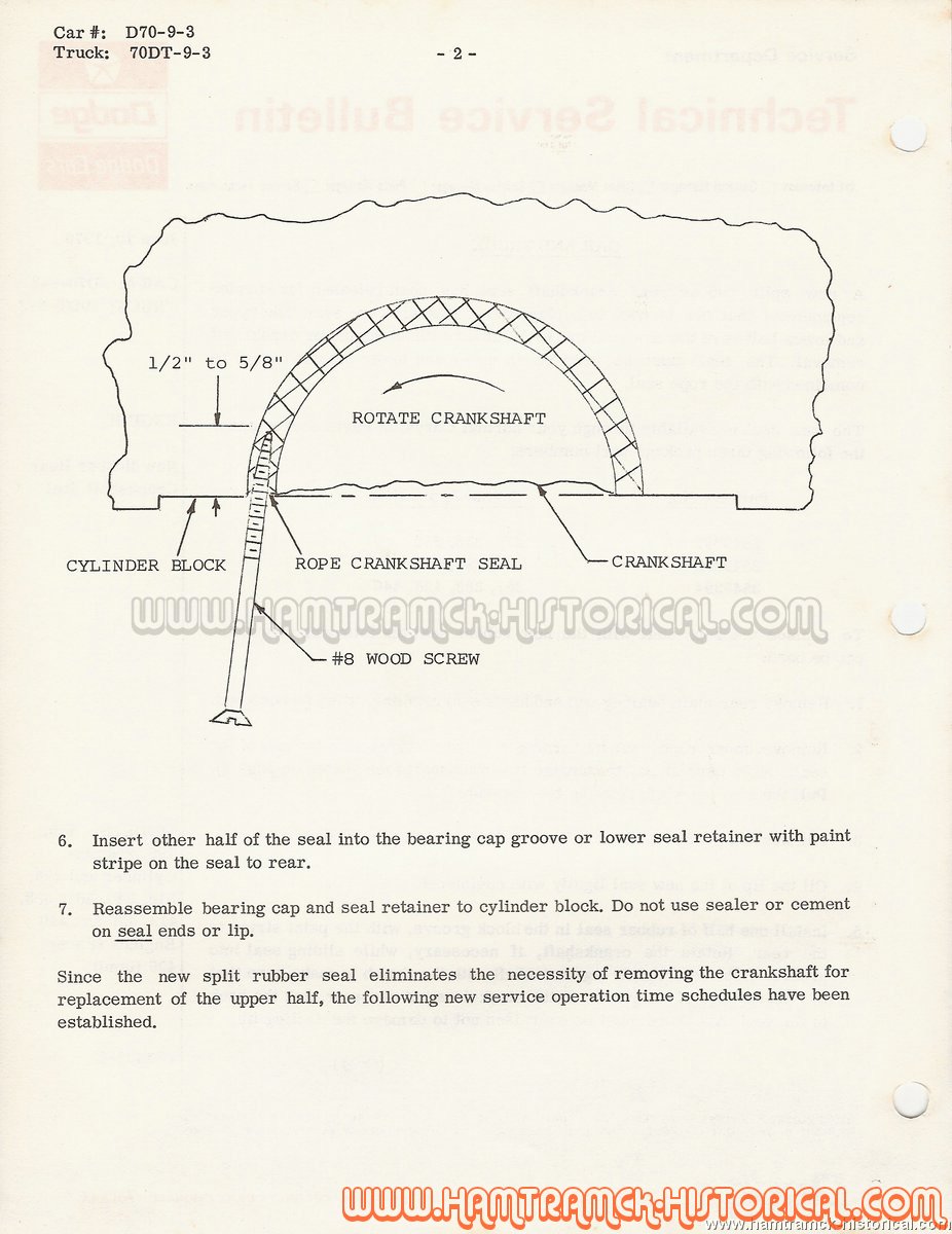

The service bulletin doesn't say to......
http://www.hamtramck-historical.com/images/TSBs/1970/D70-9-3 page1.jpg
http://www.hamtramck-historical.com/images/TSBs/1970/D70-9-3 page2.jpg
Great bulletins! Thanks for posting....
