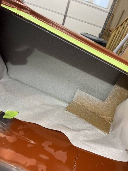

Here's the best product to replicate the texture on the insides of the rear quarters ......

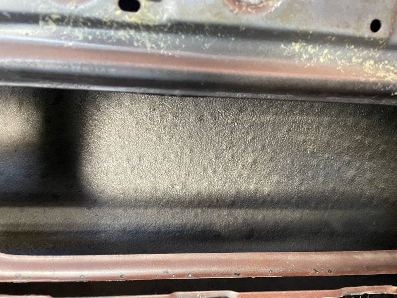

Here’s the inside door skin on my 68 …..

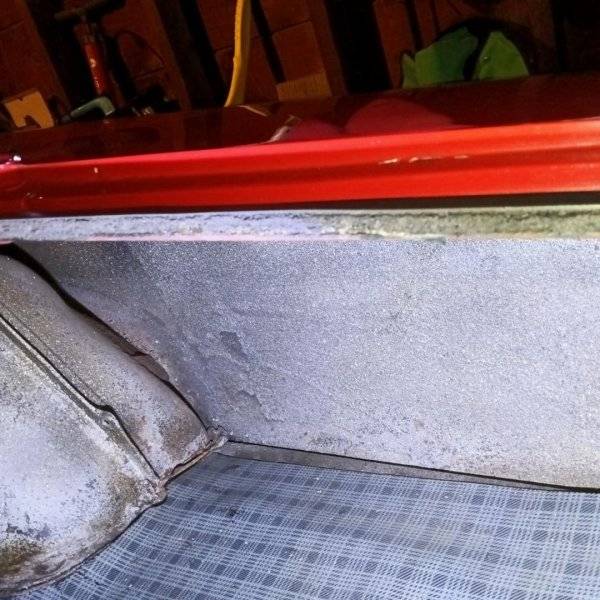

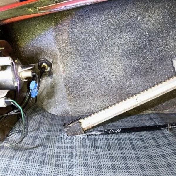

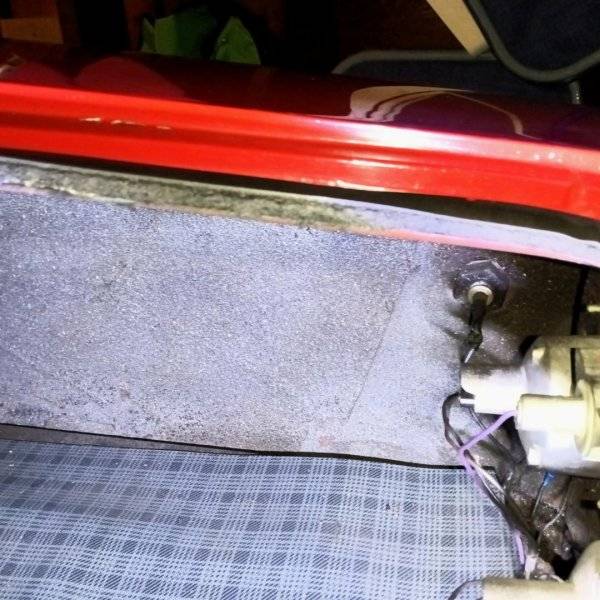

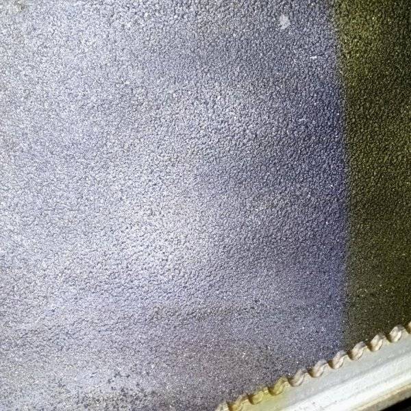

This is the inside of my 68 Charger. Not sure if it's orig. or if some po did it.

If "all original", it would be body color, not gray or black.
