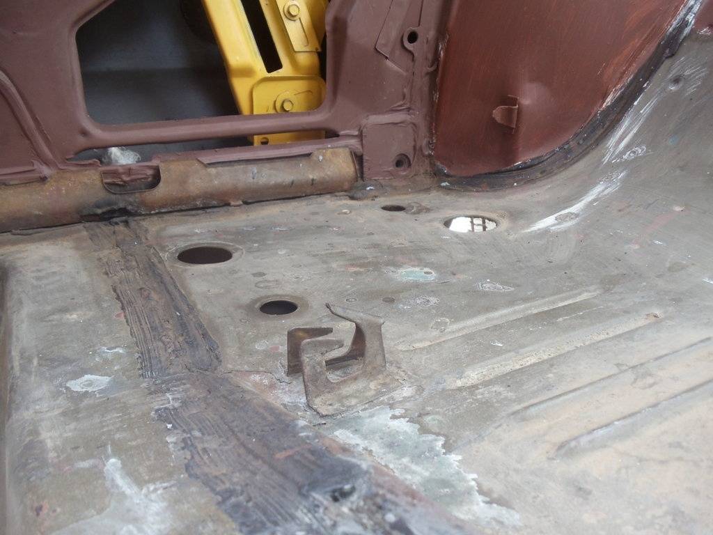

Foto below shows the catch/latch:

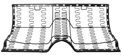

This isn't a frame from a mopar but is similar, the second rod back from the front edge is what has to be "bent /slid /bowed" to get it past the hook on the mounts. Maybe this will help you visualize it and what we're saying...
The edge is solid and you may have to push down ( on the seat top) and towards the rear so that the palms of your hand kind of catch the bar to get it to move...
