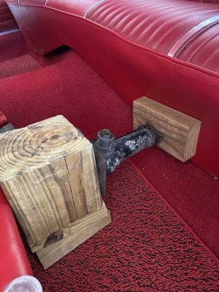

rear seat bottom removal
BeeKool for some odd reason it's not 'quite' as hard going back in.

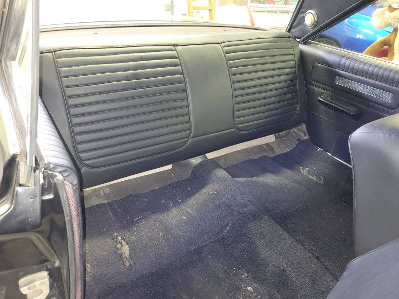

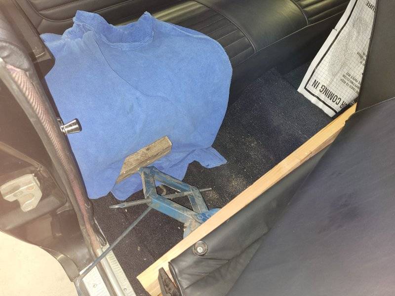

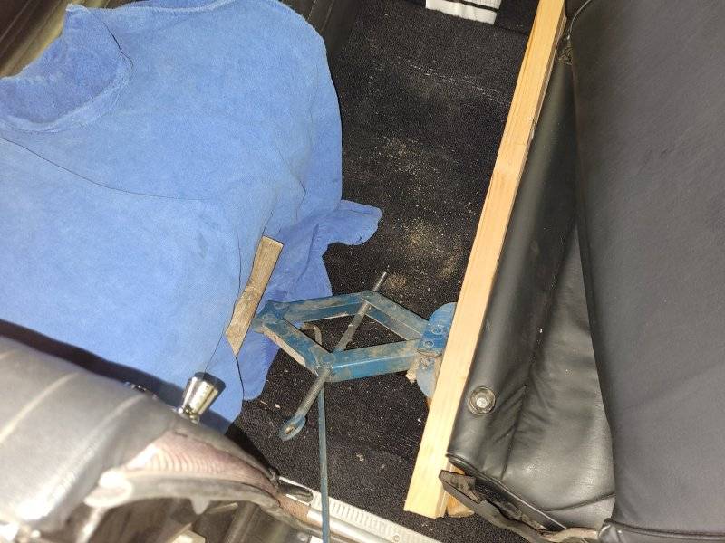

We got the seat out tonight. Notice I use the word 'we'; it took three of us to get that seat out. I took the front buckets out, two of us laying on the floor kicking the back seat hard. Passenger side popped right up on the second kick, but drivers side would not budge. Kicked that seat for several minutes, with each of us taking turns. Finally broke out two large pry bars. Two guys prying on anything they could find while I was kicking, and kicking, and kicking. Finally the drivers side popped.
