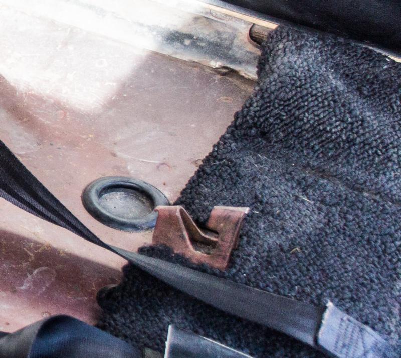

1) Push down and then BACKWARDS on the seat cushion. Push as far front on the seat whilst still having good control. The seat anchors are shaped like this:

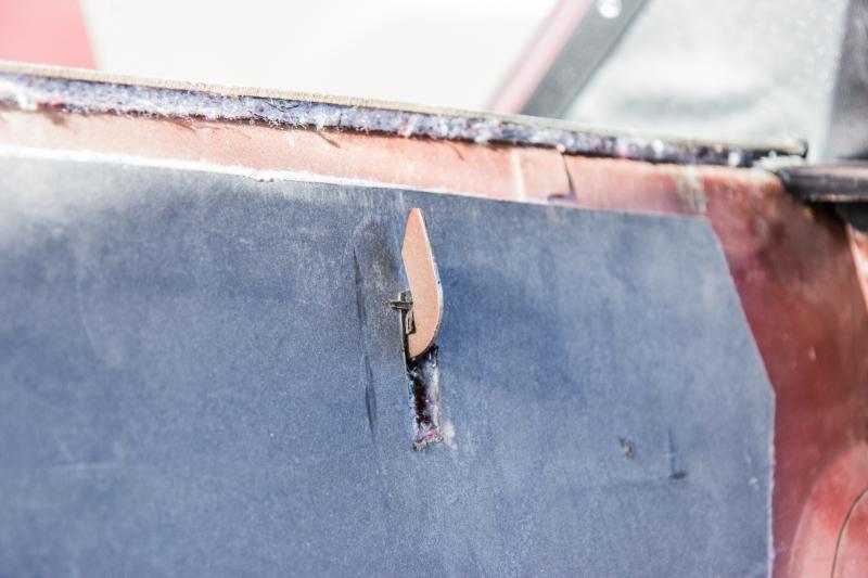

2) To remove the rear back rest. Take a look at this photo first, it is the trunk side of my car. There are some posts on here about needing to bend out some tabs or something in the trunk. If yours looks like mine...DO NOT ATTEMPT that!

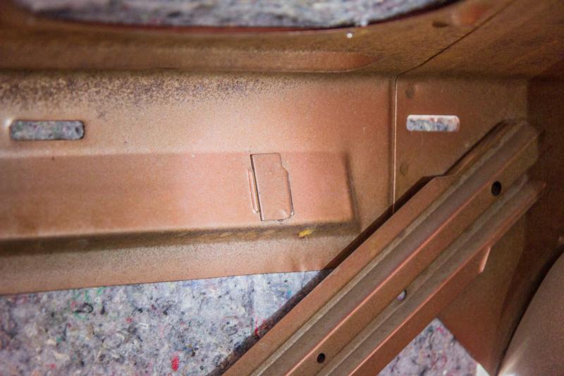

Here is a photo of the inside of the car. You can see that on the other side of the 'tab' in the trunk there is a HOOK:
The back rest simply needs to be pushed directly UPWARDS and slightly angled towards the rear of the car. As the hook bends lightly backwards to hold the back rest in place securely.
