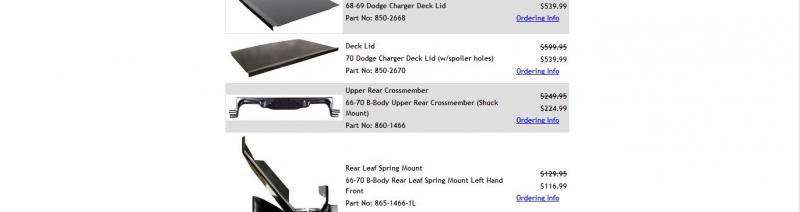

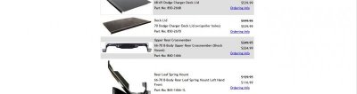

Jeff at 521 restorations could hook you up with a new one...He's a member here (jsbrown). Bring up your a FBBO member, he'll give you a discount. Gotta love some of the Joe Dirt Hack jobs folks do on these cars. Entertaining at times. Good Luck!
http://www.521restorations.com/index.pl?page=bbody&sub1=Trunk
