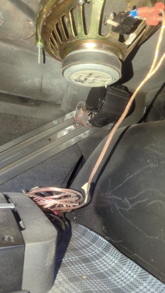

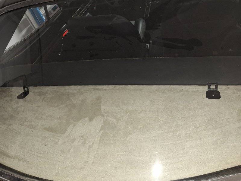

I'm curious if the package tray is where the retractors get hidden. If so, I'd think that additional reinforcements would be necessary.

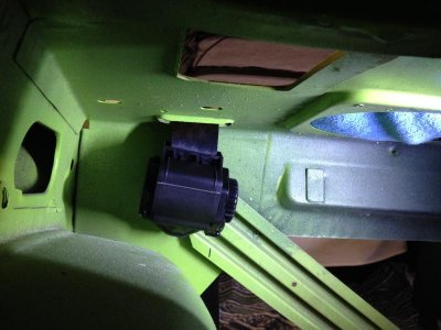

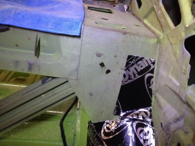

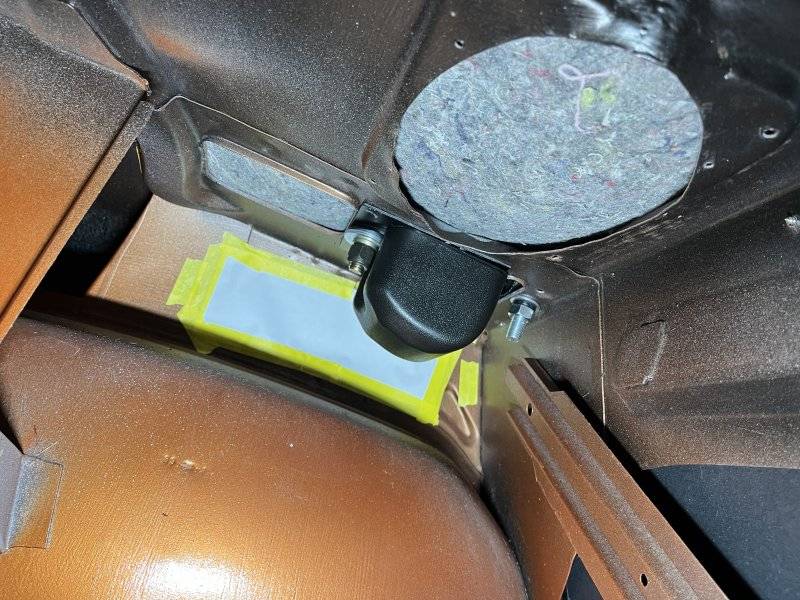

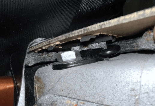

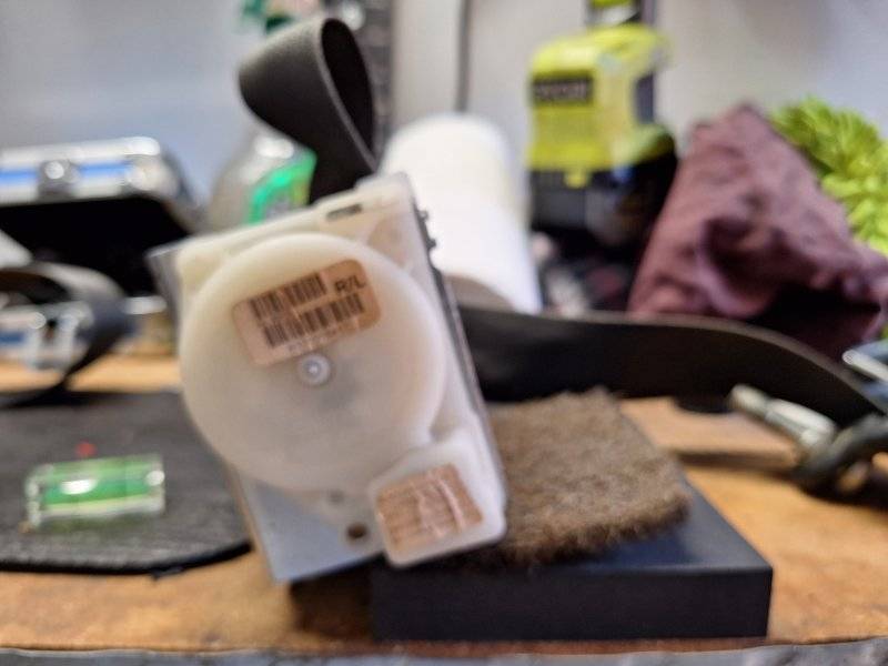

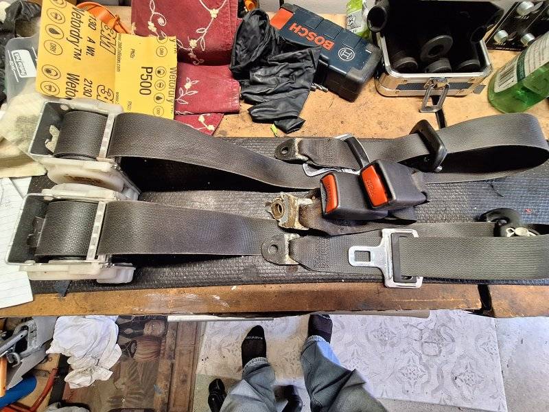

I mounted the retractor on the diagonal bracing with a big a$$ seat belt washer and grade 8 hardware. I figure if that doesn't hold in an accident, then it was so bad that no one would have survived anyway.

I welded it to that brace in my cars

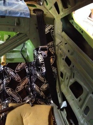

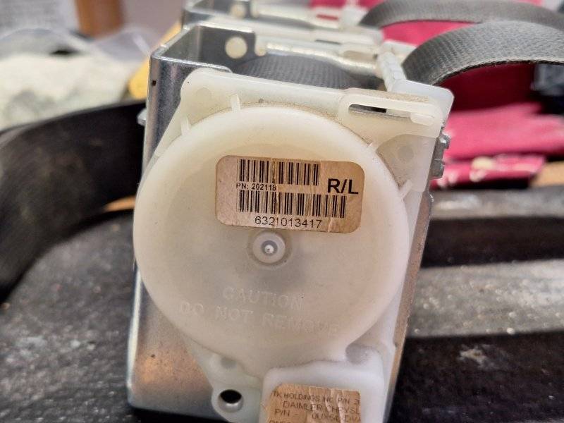

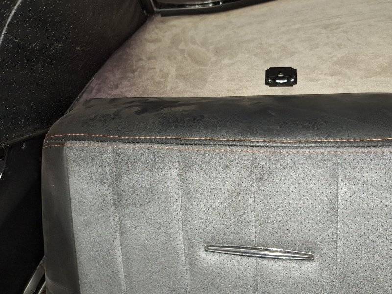

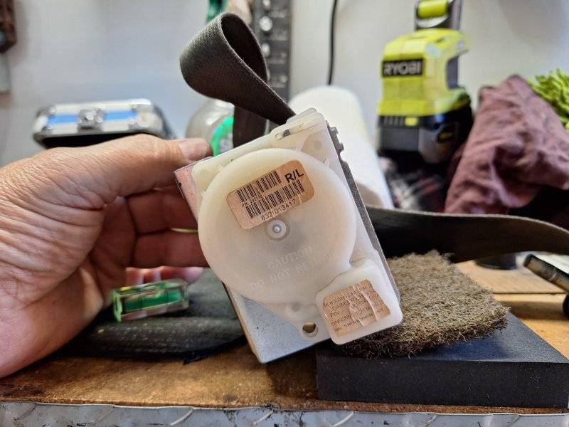

I'd be interested to see your (or someone's) setup that added back seat shoulder belts. I see those slots on my '70 Charger and it would be nice to add the extra safety for the rear passengers. What retractors and belts did you install?

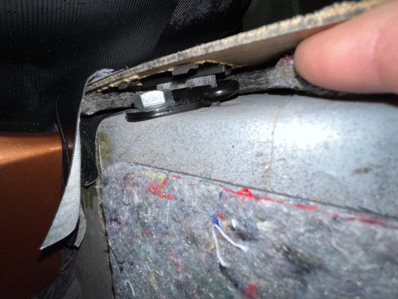

I copied your pictures:

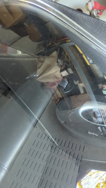

I see here that the mounting position is square with the opening in the package tray.
