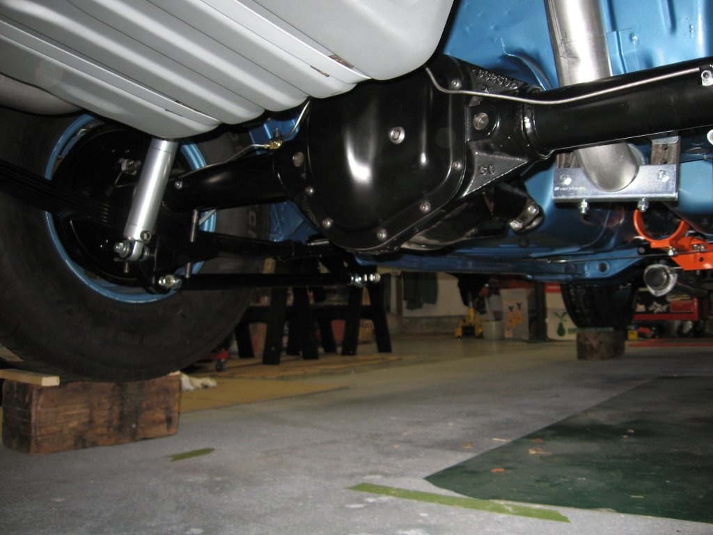

you can check my setup in my build thread, running mono leafs with the sliders, front drop hangers and double adjustable shocks, not sure how crazy you wanna go, I went with the hypercoil leafs, but it i were to do it again i'd buy the flexform leafs, they offer stiffer spring rates and less arch, other than that I'm pretty happy with my setup
On my Cuda, I use heavy duty (hemi style) springs + 1", locally-made CalTracs, and QA1 shocks. Works on the street and strip for me.
