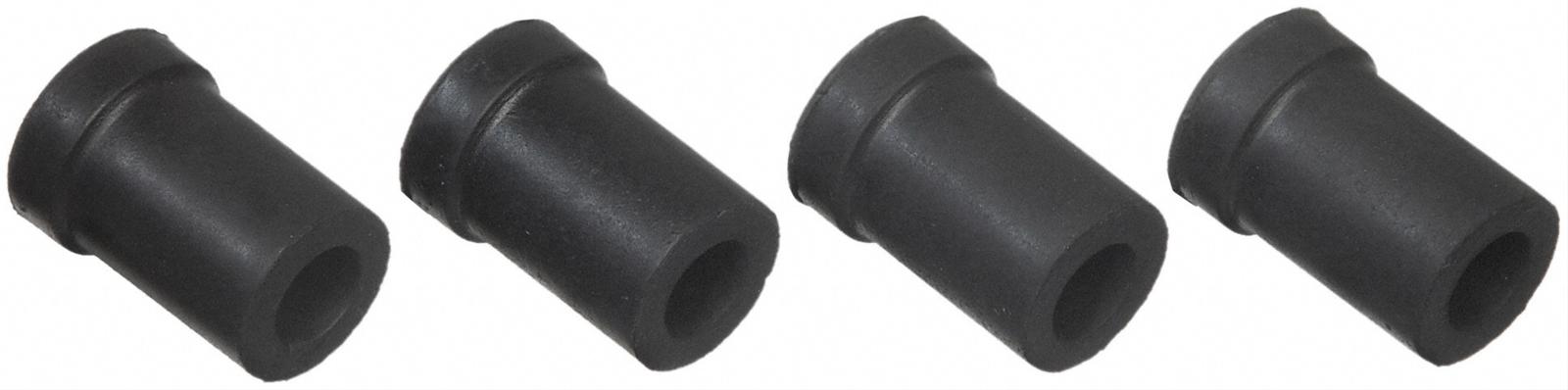

Make sure the upper shocks are tight and the bushings are good. That is the most common area for noises.
You had the car since 1999. I would change the shocks and all the bushings, they atleast 26 years old.

Check the mountings of the gas tank while you're doing the shocks and checking/replacing bushings on leaf mounts/shackles.
