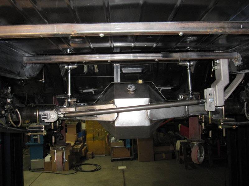

Anyone know a rear sway bar that works with mini tubs and spring relocation?
I'm using a drag race bar in my build. It fits between the frame rails and keeps unsprung weight off the axle. The links can be seen in the attached photo. The bar is clear up to the top of the axle frame hump. Check with Jegs or Summit, they both sell the kits.
Mike
Paul Horton Welder Series sell a universal kit that u can cut to fit with multiple attachment options.
