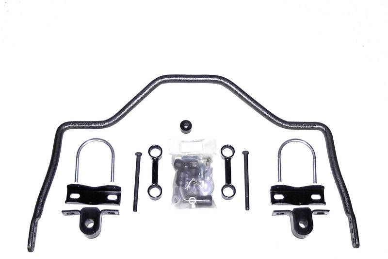

I'm thinking about adding a rear sway bar to my 71 Road Runner. I'm leaning towards the one from Firm Feel which mounts to the frame like the factory one. Also considering one from Hellwig which mounts below the rear end. What are the pro and cons between the two mounting options?
by the pic, it seems the Hellwig sway bar is based on E body design, but runs above rear end, not below. The original one runs below.
I think the Hellwig design could get some interference with exhaust if going with huge pipes like 3"

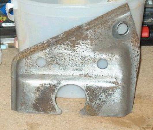

this is the sway bar plate used on 72s, to fit between axle and springs
mages?q=tbn:ANd9GcSxChOMctkh2Yj2LBoY9BCs0XYtIYdbtv2adLpaRV9OIWJgd9Egc4CWrxZryMqKMKvCN4Y&usqp=CAU.jpg
which is not included on the ADDCO kit

Correcting myself... The Hellwig bar doesn't mount like E bodies LOL... Both mounts somehow underneath the axle... just checked the instructions sheet.
It seems the Hellwig kit is complete, and the long bolt is the one which completes the installation to the body frame, whithout a plate like the stock ones ( on E and B bodies )

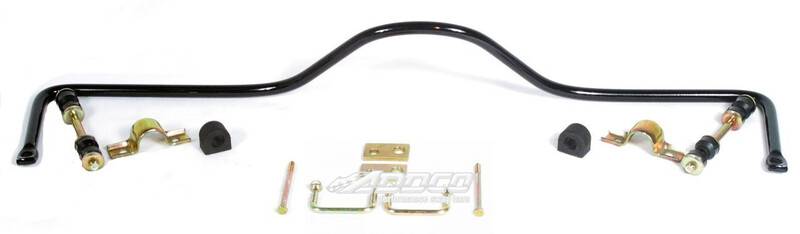

and I'm checking the Addco changed a bit their design. They are not anymore like the stock one being straight ( or that was what My friend got ), neither attachs to the axle anymore, but still the "attaching plate" to the shock plate is awfull IMHO
If somebody ask me, I think going over the axle could disturb on to the exhaust pipes. Maybe not a problem on stock pipes sizes, or a bit larger, but going huge could be a problem

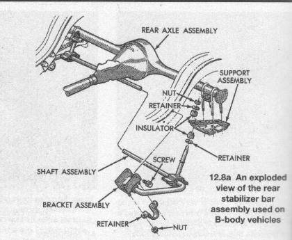

Do you have a picture of how the factory B body bar mounted. I looked in my service manual bit it does not show.
I put an Addco on mine that I got from a fella selling some engine parts I was buying. It was NIB and came with some other parts he acquired but he had no 71-4 B cars. I got it dirt cheap & put it on with no issues but do plan on replacing the mount plates with something heavier before the car hits the street.
Because 71s didn't get the option. First year for B bodies was 72, hence why your 71 Manual doesn't show it
I posted how it is ( although picture is small ) on the reply #7.

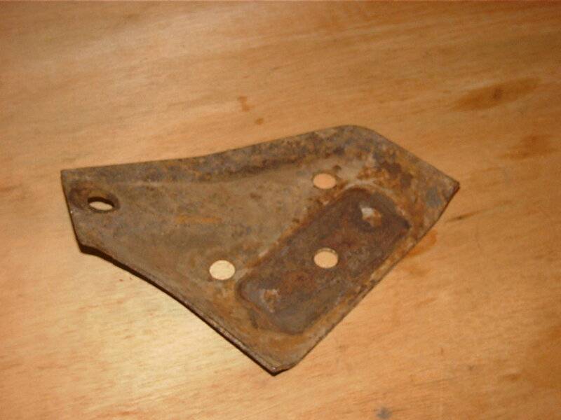

And reply #2 gets a view of the sway bar plate between axle and springs for 72.

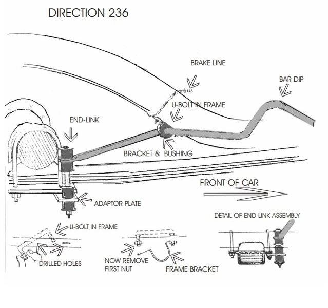

maybe this will upload a bit bigger
and this on a close up of the assembly... As far I recall this is ADDCO rear sway bar, using the stock frame bracket ( just the bracket, not the bushing clamp ) and the plate down the axle
Plate down the axle for 72
same piece but for 73 and lates, due the spring isolation system/clamp.
