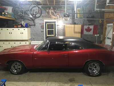

What are all you guys running for a rear universal joint with a 8 3/4 suregrip rear end ? .. I have sheared 2 universal joints on the differential end so far this year. The car is equipped with a 500 stroker running 460 HP and 570 ft/lbs and a 727 auto . I want to get something heavy duty so I dont have to worry about it when I hop on the throttle . I have added pictures of the u joint I was running and the damage , also a pic of the car for ride height

Have you altered the ride height or rear suspension? Tells us more about this car. Seems like you have a Pinion angle problem to have this happen twice.

1-Car body might be sprung out of alignment (or) Possible causes of problems relating to the driveshaft when, the driveshaft rpm will be up and U joint drops the shaft....2- How long the shaft ... 3-The most basic causes of problems in a driveshaft come from the shaft being bent or out of balance.
just a thought.....
