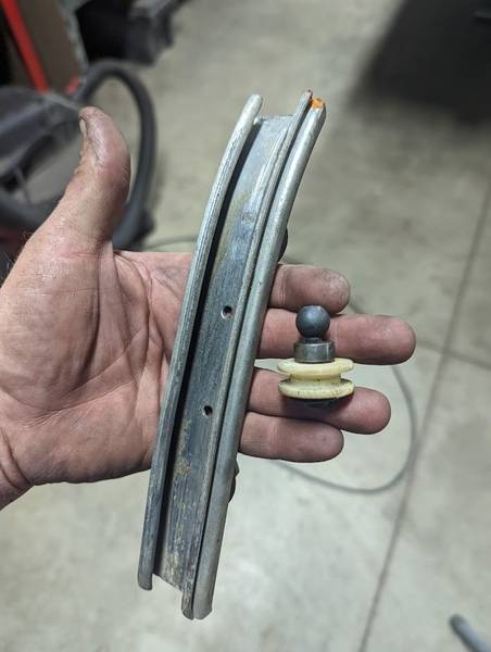

Another question. So I pulled apart the driver side and found this roller laying in the bottom of the 1/4. So I cleaned it up and now I'm trying to figure out where it goes. I think it's supposed to ride in this track somehow, but I'm guessing there is a piece missing? The white roller fits into the aluminum casting that the window is in. So, I open up the passenger side just so I can see how it goes together, and low and behold there is one of those laying in the bottom of the 1/4 as well...............

If that is the rearmost track in your hand (I think it is) then that roller most likely rides in it. It was missing in one of mine too and was a real pain to install. I think I found that it was easiest with the glass lowered all the way. There is another piece to that roller but I will need to look it up to describe.

I think that’s the roller that rides in the track. There is a second roller/slide with one of those washer clips that slides in the rear groove of the glass holder frame. I think that ball stud fits in it. Do you have a factory service manual? The body assembly section should have a detail on it.
That's the part I had to order. It's missing the part that the ball stud presses into. Hopefully all will make sense when I get the new kit.
