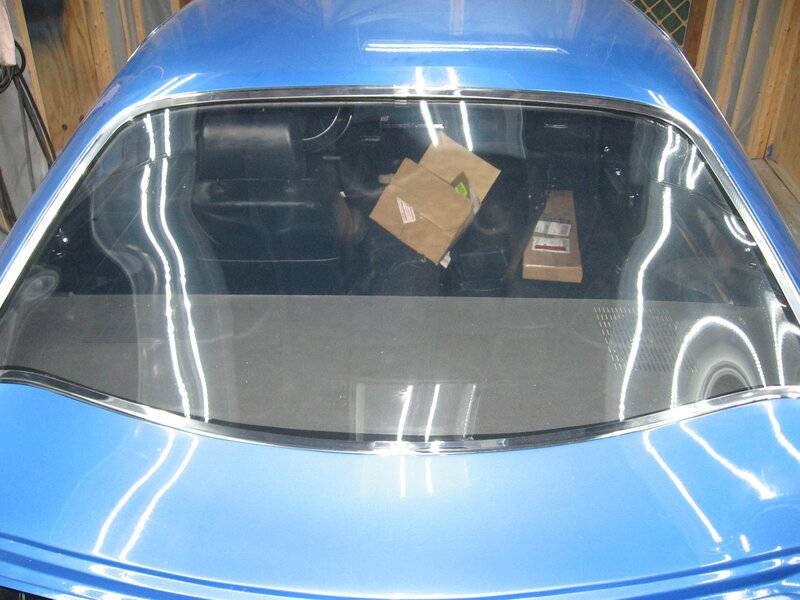

As you all know what a time I had with the window. So have one in now.

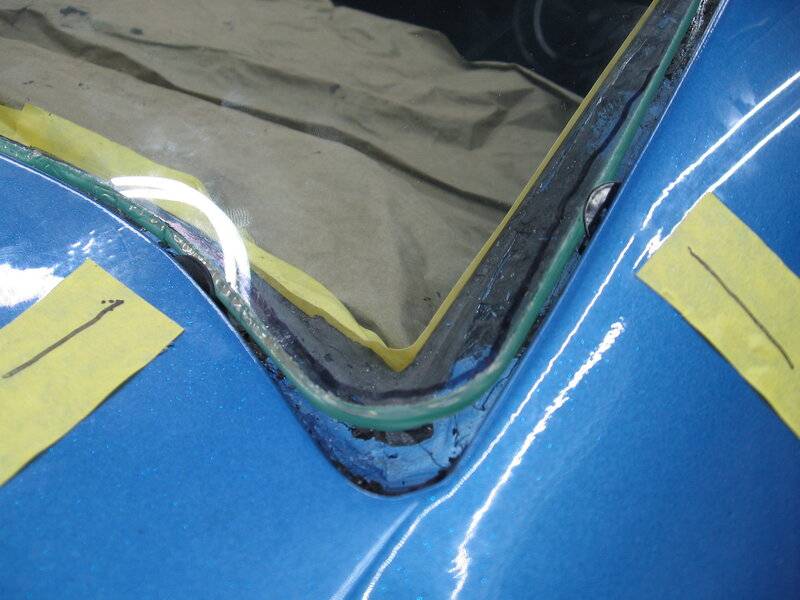

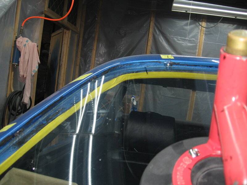

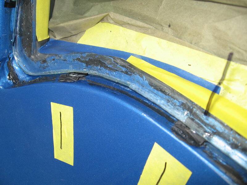

Hope this will give you enough of an idea where to place the clip's don't know why I did not take a full on picture of them all. This was the first glass I got from the guy I had them made form.
